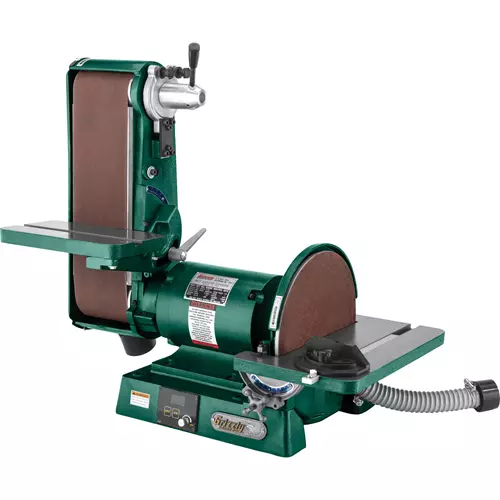

G0997 Variable-Speed 6" x 48" Belt / 12" Disc Combo Sander
A versatile variable-speed combination sander for woodworking and metalworking professionals.
This variable-speed belt/disc combination sander offers enhanced control compared to fixed or multi-select speed sanders!
The speed adjustability makes the sander ideal for wood as well as metal work, so you can control heat levels on all workpiece types and prevent metal discoloration and warping.
If you need versatility in a sander, you will appreciate the ability to use this model both horizontally and vertically with easy adjustability.
With additional features such as a quick-release belt, cast-iron tables, fine tracking knob, and miter gauge, this combination sander is ready to smooth cabinet corners, polish metal fixtures, and refinish worn door surfaces.
FEATURES and BENEFITS:
  • Variable Speed: The speed is easy to change between 900-3000 FPM for finer adjustments, greater precision, and smooth results on every project.
  • Versatile Use: Operates both horizontally and vertically and can be used with a wide range of material types, including softwoods, hardwoods, and various metals.
  • Quick-Release Belt: Untensioning and belt changes are simple with a lever that easily releases the belt.
  • Cast-Iron Tables: Separate highly durable tables for belt and disc sanding each tilt as needed to accommodate both wood and metal workpieces.
  • Fine Tracking Knob: Located on the top roller to ensure precision tracking during the sanding process.
  • Miter Gauge: Get the exact angle you want for every sanding pass; essential for even, repeatable sanding results.
  • Motor: 1-1/4 HP, 110V/220V, 3-phase (w/inverter for single-phase power), 24A/12A
  • Sanding belt size: 6" x 48"
  • Sanding belt speed: 1180–3920 FPM
  • Belt platen size: 6-1/2" W x 14-1/2" L
  • Belt table size: 6-7/8" W x 12-5/8" L
  • Belt table tilt: 45° to -30°
  • Disc diameter: 12"
  • Disc backing type: PSA
  • Disc speed: 900–3000 RPM
  • Disc table size: 7" W x 16-1/2" L
  • Disc table tilt: 45° to -20°
  • Dust ports: (2), 2-1/2", 3"
  • Footprint: 14" x 16-1/2"
  • Overall dimensions: 32-1/2" x 30" x 29-1/2"
  • Approximate shipping weight: 159 lbs.
This dual-operation combination belt and disc sander is equipped to provide smooth, consistent results due to variable-speed adjustability and other user-friendly offerings.
Streamline your sanding processes by adding the G0997 Variable-Speed 6" x 48" Belt / 12" Disc Combo Sander to your shop today!
