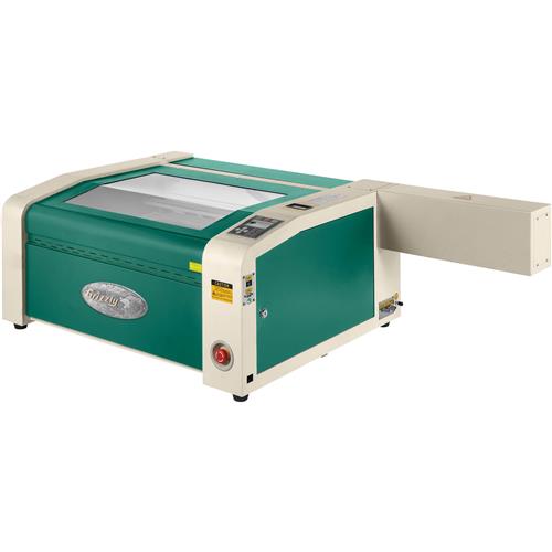

G0872 60W Benchtop 17" x 23" CNC Laser Cutter/Engraver
Bringing tabletop CO2 laser speed and precision to the forefront.
The G0872 17" x 23" CNC Laser Cutter/Engraver can produce amazingly detailed, high resolution designs with stepper controlled movements on linear bearing rails and refined optics.
The 60W laser can cut through various plastics, wood types, fabrics, vinyl, and even leather. It is not designed to cut through metal.
With the ability to bump the power down a notch, you can perform etching and engraving operations as well.
With engraving speeds over 1,900 millimeters per minute and accuracy better than 0.05mm, this machine produces amazing results in a flash.
The G0872 can cut features as small as one square millimeter. Allow this laser do all of that meticulous cutting and send your productivity through the roof.
The G0872 is only compatible with the included RDCam V8 design software. For other CNC laser cutter/engravers that are compatible with additional design software, please see the G0873 and G0874.
Designs and photos with the following file extensions can be imported to the laser software for processing: .svg, .ai, .pdf, .dxf, .hpgl, .plt, .png, .jpg, .bmp, and .jpeg.
Like all of Grizzly CNC laser cutters, the G0872 comes with a 1-year warranty covering parts and assuring the unit is free from factory defects. (Consumables are not covered by the warranty.)
The G0872 manual was written by our U.S. based Documentation Department is packed with useful information.
The Grizzly Technical Support team is U.S. based. Parts for the Grizzly CNC laser cutter may be available online and shipped from the Grizzly parts warehouse in Springfield, MO.
Made in an ISO 9001 Factory
  • Laser type: Sealed CO2 laser tube
  • Laser power: 60W
  • Wavelength: 10,600nm
  • Cutting area: 17" x 23"
  • Cutting speed: 0–1900 mm/min.
  • Cutting accuracy: 0.05mm
  • Resetting position accuracy: +-0.002"
  • Minimum shaping character: 0.04" x 0.04"
  • Overall size: 61" W x 32" D x 18" H
  • Approximate shipping weight: 287 lbs.
  • Manual laser focus
  • Manual worktable adjustment
  • Stepper driving system
  • Water cooling and protection system cooling modes
  • Includes: extraction fan, air exhaust hose, water cooler, honeycomb table, air pump, 60W laser tube and design software
