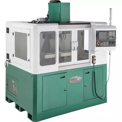

G0876 8" x 27" Enclosed CNC Mill w/Auto Tool Changer
Built with production in mind, the G0876 8" x 27" Enclosed CNC Mill with Auto Tool Changer features a 3 HP BT30 driven spindle.
Paired with an 8-position automatic tool changer and a powered pull stud, it's the perfect recipe for making some serious chips and doing so quickly.
The hands-free tool changer eliminates the need to babysit the machining cycle and allows you to maximize your most valuable resource, time.
With the Siemens® Sinumerik CNC controller at the helm and powerful servo motors driving ball screws on all axes, the machine is built for accuracy.
With a 10,000 RPM spindle and rapid speeds of 400in./min. this machine can produce repeatable parts, fast!
All this wrapped in an enclosed cabinet with a high flow 13-gallon coolant tank and you have a machine ready to go to work for you.
The G0876 comes with a 1-year warranty which covers parts and assures the unit is free from factory defects. (Consumables are not covered by the warranty.)
Parts for the mill may be available online and shipped from the Grizzly parts warehouse in Springfield, MO.
  • Spindle motor: 3 HP, 220V, 3-Phase, 6.4A
  • Spindle taper: BT30
  • Spindles speeds: Variable, 50–10,000 RPM
  • X- and Y- motors: 1 HP, 2.1A
  • Z- motor: 1.3 HP, 3A
  • Spindle to column: 11"
  • Spindle to table: 16-1/2"
  • Longitudinal travel: 12-3/16"
  • Cross travel: 7-3/4"
  • Vertical travel: 11-3/4"
  • Position resolution: +-0.0008"
  • Repeat position resolution: +-0.0005"
  • Tool changer: 8 positions
  • Tool change speed: 6 seconds
  • Max tooling weight: 13 lbs.
  • Table Size: 8-1/4" x 27"
  • Table T-slots: (3) 5/8"
  • Max workpiece weight: 220 lbs.
  • Rapid speed: 400 in./min.
  • Coolant tank capacity: 13 gallons
  • Footprint: 110" x 86"
  • Overall dimensions: 71" W x 65" D x 79" H
  • Approximate shipping weight: 3350 lbs.
  • Siemens® Sinumerik CNC controller
  • Servo motors with ball screws on all axes
  • Built in pendant/hand controller
  • Powerful 3 HP main motor
  • 50-10000 RPM spindle speeds
  • Easy access to table from three sides
  • Hands-free tool changes with 8-position automatic changer
  • Rapid table speeds of up to 400 in./min.
  • Heavy duty BT30 spindle included
