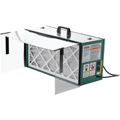

G9955 Benchtop Dual Fan Air Filter
An air filter perfect for pairing with sanding and power carving.
The G9955 Benchtop Dual Fan Air Filter is a point-of-use filter, designed specifically to filter fine airborne dust particles.
Two separately switched fan motors can be used to draw a maximum 400 CFM of your dusty shop air though the 5-micron pleated filter.
The clear plastic hood helps to direct flow from the work area directly into the filter.
Like all Grizzly dust filters, the G9955 comes with a 1-year warranty.
The G9955 manual was written by our U.S.-based Technical Documentation Department and is packed with useful information. The complete and easy-to-read manual provides full instructions on how to assemble and maintain your filter.
Parts for the filter may be available online and shipped from the Grizzly parts warehouse in Springfield, MO.
  • Motors: twin 1/20 HP, 110V, single-phase, 0.4A
  • Air suction capacity: 200 CFM x 2
  • Impeller type: Open fan
  • Impeller size: 5-5/8"
  • Filtration: 5 micron
  • Filter size: 20" L x 10" W x 2" T
  • Overall dimensions: 20-7/8" L x 8-1/4" W x 10-1/2" H
  • Shipping weight: 24 lbs.
  • Non-marring rubber feet
  • Clear plastic hood
  • Two 110V outlets for woodworking tools
  • Two motors independently controlled
