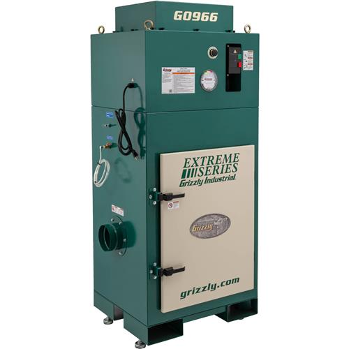

G0966 1-1/2 HP Metal Dust Collector with Spark Deflector
Improve air quality and enhance workplace safety with metal dust collection.
This heavy-duty 2-stage HEPA metal dust collector captures dry metal, chips, swarf, dust, and particles down to 0.2 microns for a safer, more productive shop environment.
Collecting metal dust offers extensive benefits, including a cleaner workspace, enhanced equipment and product protection, and improved overall air quality.
Flame-Resistant Canister Filter: The canister filter protects you from welding and cutting slag flare-ups while providing the essential first step of filtration. This filter provides 2-micron filtration at 95%.
HEPA Filtration at 99.99% Efficiency: The MERV-17 HEPA filter provides filtration down to 0.3 micron so that you can breathe easy! Complete your metalworking projects with confidence in the quality of your shop air.
Powerful Motor: This unit features a 1-1/2 motor providing high 884 CFM air volume. The result–extreme metal dust collection!
No-Guess Filter Replacement: A built-in vacuum pressure gauge indicates when filter cleaning or replacement is needed. No guesswork involved!
Pneumatic Cleaning Process: The cleaning process is simple. The air pulse button allows for pneumatic cleaning, and an industrial quick coupler plug connection for easy use.
Simple Dust Disposal: The removable dust tray makes it easy to dispose of the metal dust.
Standard 120V Power: This machine runs on 120V single-phase power. You don’t need a 220V connection to get the metal dust collection you need.
Sturdy Construction: The steel body and powder-coated finish provide a solid framework to keep the machine up and running for years. And at 513 pounds, this dust collector is sturdy enough to withstand extensive shop wear and tear.
  • Motor: 1-1/2 HP, 120V/240V (prewired for 120V), single-phase, 18A/9A
  • Airflow performance: 884 CFM @ 2.2" SP
  • Max. static pressure (at 0 CFM): 8.3"
  • Inlet size: 6"
  • Machine collection capacity: 1
  • Material collection capacity: 0.55 cu. ft.
  • Air input connection size: 1/4" NPT
  • Tank size: 1 Gallon
  • Maximum tank pressure: 90 PSI
  • Footprint: 30" x 26"
  • Overall dimensions: 33-1/2" W x 29" D x 74-1/2" H
  • Approximate shipping weight: 661 lbs.
Note: DO NOT use this dust collector to collect wood dust or metal chips containing cutting fluid or coolant. For best results, only use metal ducting to connect each machine.
