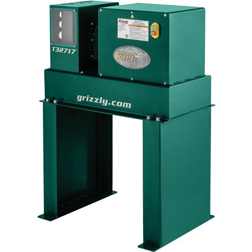

T32717 Electric Pipe & Tube Notcher with Stand
Quickly notch pipe & tubing to keep your production on schedule.
The T32717 Electric Pipe & Tube Notcher is designed to quickly notch or cope the ends of metal pipe or tubing.
Choose from eight notching holes with OD diameters from 1/4" to 2-1/4" with a max walls thickness of .133.
The chip drawer catches notching chips and cut off pieces and is removable for easy emptying.
Like all Grizzly notchers, the T32717 comes with a 1-year warranty which covers parts and assures the unit is free from factory defects.
The T32717 owner’s manual was written by our U.S.-based Technical Documentation Department and is packed with useful information.
The Grizzly Customer Service and Technical Support Teams are also U.S.-based.
Parts and accessories for the notcher are available online and shipped from the Grizzly parts warehouse in Springfield, MO.
SPECIFICATIONS
  • Motor: 1-1/2 HP, 220V, single-phase, 8A
  • Pipe notching capacity (OD | Schedule 40): 1/4", 3/8", 1/2", 3/4", 1"
  • Notching hole sizes: 1/4", 3/8", 1/2", 3/4", 1", 1-1/4", 2", 2-1/4"
  • Maximum wall thickness: .133
  • Suitable materials: Carbon steel, non-ferrous materials
  • Notch angle: 90°
  • Gear oil capacity: 2.1 Quarts
  • Overall dimensions: 33" W x 22-1/2" D x 48" H
  • Approximate shipping weight: 452 lbs.
  • Removable chip drawer
  • Transparent viewing windows
  • AISI 4140 steel notching dies
