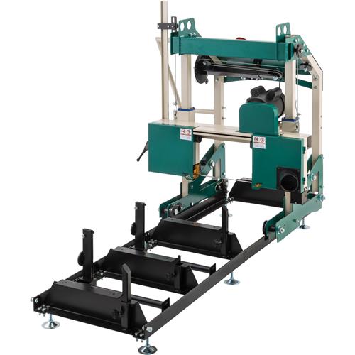

The G0960 Electric Sawmill will cut logs and lumber down to size. Designed for the homeowner to use, this Shop Series mill runs on 110-volt electricity with no special electrical hookups or gas needed.
Produce your own lumber for any number of hobbyist or construction projects. Turn small logs into useable lumber and make bowl blanks from downed trees.
The Grizzly Mini Sawmill can handle logs up to 13-inch diameter and flat stock up to 13 inches wide. Two adjustable work stops hold the log in place, while a manually adjusted workpiece clamp prevents movement during cuts.
It is designed for quick setup with a rock-solid, steel track with adjustable feet capable of leveling on just about any surface. The 6-1/2-foot-long track is modular, allowing you to easily attach and level additional T33224 3-foot-long Bed Extension Rails in order to mill practically any length of lumber you need.
These economical sawmills can be easily stored when not in use. It’s lightweight and compact takes up less than a 4’ x 7’ storage space.

- Motor: 2 HP, 110V/220V, (prewired for 110V), single-phase, 14A/7A
- Maximum log length: 43-5/16"
- Minimum log length: 20"
- Maximum log diameter: 13"
- Minimum log diameter: 4"
- Maximum cut width: 13"
- Maximum cut thickness: 6-1/2"
- Minimum cut thickness: 0.075"
- Maximum cut height: 14-1/2"
- Blade size: 84-1/2" x 3/4" x .025"
- Blade speed: 2900 FPM
- Track length: 78-1/2"
- Overall dimensions: 44-1/2" W x 79" D x 64" H
- Approximate shipping weight: 585 lbs.
- 13" Maximum log diameter and width of cut
- Ceramic blade guides
- Manual lift system raises 0.2" per revolution
- Low-to-the-ground bed
- Two adjustable log supports and two log clamps
- 1-year limited warranty
