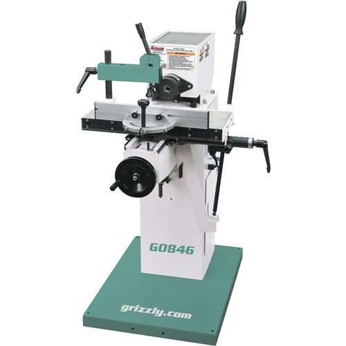

G0846 Horizontal Slot Mortiser
A must-have for custom furniture builders, cabinetry builders or other woodworkers using mortise and tenon joinery.
The Grizzly G0846 Horizontal Slot Mortiser incorporates a router mounted on its side with the workpiece clamped to a multi-axis sliding table.
Use it to quickly cut mortises for traditional mortise-and-tenon or 'loose tenon' joinery and easily cut angled mortises as no elaborate jigs and fixtures are required!
The G0846 is driven by a powerful 2-horsepower, 220V, 10-amp motor and is equipped with a 20" x 8-1/4" precision-ground cast-iron table.
The table features an adjustable cam-action hold-down clamp to secure the workpiece.
The table glides along two hardened V-ways using four ball bearings for smooth, effortless motion.
The table has two adjustable X-axis (side-to-side) stops and one Y-axis (depth) stop.
The G0846 has an indexing guide with four spacing patterns that, when combined with the stops, are all crucial for repeat operations and production work.
Adding this Horizontal Slot Mortiser to your shop will dramatically increase your capability, production and efficiency.
Like all Grizzly mortisers, the G0846 comes with a 1-year warranty which covers parts and assures the unit is free from factory defects.
The G0846 manual was written by our U.S. based Technical Documentation Department and is packed with useful information. The complete and easy to read manual makes it easier to assemble and maintain your horizontal slot mortiser.
The Grizzly Customer Service and Technical Support Teams are U.S. based. Parts and accessories for the mortiser are available on-line and shipped from the Grizzly parts warehouse in Springfield, MO.
- Motor: 2 HP, 220V, single-phase, 10A
- Maximum stock thickness: 10-3/4"
- Table cross travel: 6"
- Table longitudinal travel: 12-1/2"
- Table vertical travel: 5-1/2"
- Table size: 8-1/4" x 20"
- Indexing guide increments: 5/8", 3/4", 7/8", and 1"
- Chuck capacity: 5/8"
- Dust port size: 4"
- Footprint: 27-1/2" x 20-1/2"
- Overall dimensions: 32" W x 36" D x 48-1/2" H
- Approximate shipping weight: 315 lb.
- Westcott-style 2-jaw chuck
- Precision-ground, cast-iron table
- Forward and reverse spindle control
- Longitudinal X- and Y-axis table stops (indexed at 5/8", 3/4", 7/8", 1)
- Smooth ball-bearing table operation
- Locking miter gauge
- Cam-action hold-down clamp
- Locking storage cabinet
- Hex wrench set included
