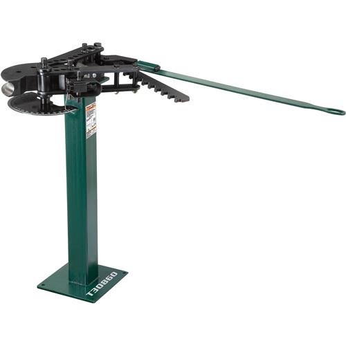

T30860 Grizzly Manual Tube Bender
Bend tubing the right way, your way.
The T30860 Manual Tube Bender provides a stable and durable platform for tube bending that is quick to set up and easy to use.
Manual tube benders can be used with minimal training to provide accurate and consistent bends with a variety of tubing materials including steel, copper, and aluminum.
The T30860 is capable of bending round tubing from 1/2" to 2" diameter or square metal tubing from 1" to 2" diameter.
Make bends up to 180° with complete confidence.
Thanks to its durable steel construction, once the tool is anchored in place, it will bend tube for years.
Whether you are building a rugged roll cage, an ultralight frame, or making repairs to machinery, the T30860 Manual Tube Bender will get the job done!
This tool includes a floor-mounted stand, bend angle indicator, and removable 41" handle.
Optional dies are available (not included) for various sizes of round and square tubing.
The manual for the T30860 was written by our U.S.-based Technical Documentation Department and is packed with useful information.
Parts for the tube bender may be available online and shipped from the Grizzly parts warehouse in Springfield, MO.
SPECIFICATIONS
  • Minimum tube diameter: 1/2"
  • Maximum tube diameter: 2"
  • Minimum square tube size: 1"
  • Maximum square tube size: 2"
  • Minimum wall thickness: 1/16"
  • Maximum tubing thickness: 1"
  • Maximum bending angle: 180°
  • Handle length: 41"
  • Overall height: 45"
  • Footprint: 11-3/4" x 11-3/4"
  • Approximate shipping weight: 100 lbs.
FEATURES
  • Steel construction
  • Floor-mounted stand
  • Bend angle indicator
  • Removable 41” handle
  • 17 optional dies available (not included)
  • 1-year limited warranty
Note: Not for flat stock.
