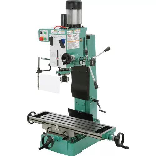

You won't believe this price after you've read the specs and features on this machine! Start with a dovetail column for accuracy, quick speed changes with the gear head, tilting head for angled cutting, drilling or tapping and so much more. Take a close look at the capacities and other specifications of this machine!
Features:
  • Tapping switch
  • Manual feed reverse
  • Eye shield
  • Quill lock
  • 1-1/4" drilling capacity
  • 3" face milling capacity
  • 1/2" tapping capacity
  • Reversing switch
  • Direct drive
  • Spindle taper: R-8
  • Spindle travel: 4-15/16"
  • Quill diameter: 2.95"
  • Table size: 9-1/2" x 32-1/4"
  • Table width end to end (tip of handwheel to tip of handwheel): 45-3/4"
  • Table travel (longitudinal): 21-5/8"
  • Table travel (cross): 7-1/2"
  • Max. dist. spindle to table: 18 5/8""
  • Max. dist. spindle to column: 10-1/2"
  • Machine depth (back of column to tip of front handwheel): 31-1/4"
  • Machine height 55-1/4"
  • Head tilt: 90º both ways
  • Head swivel: 360º
  • T-slots: 4 slots, 1/2" studs
  • Range of 6 speeds: 120-1970 RPM
  • Motor: 1 HP, three-phase, 220V
  • Approximate shipping weight: 673 lbs.
