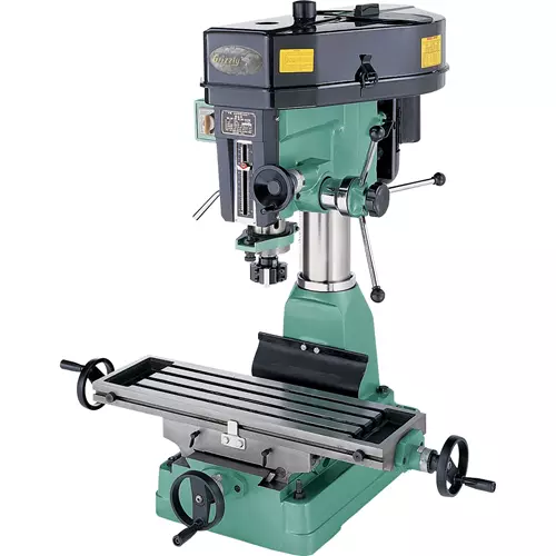

This is one of the best bargains on the market today. This Milling / Drilling machine features a powerful 2 H.P. motor, standard R-8 spindle with 5" of travel, 4-1/2" cast iron column, easy-to-read dials, reversing switch and more. And its a heavy brute! Weighing in at 620 lbs., you can expect lots of rigid, heavy duty performance. A lot of machine for the dollar; check out the specs below.
  • Spindle taper: R-8
  • Spindle travel: 5"
  • Swing: 15-7/8"
  • Max. distance spindle nose to table: 17-3/4"
  • Column size: 4-1/2"
  • Table size: 28-3/4" x 8-1/4"
  • Max. table travel: 19-3/9"
  • Cross-slide travel: 7"
  • Drilling capacity: 1-1/4"
  • Number of speeds: 12
  • Range of speeds: 140-2570 RPM
  • Motor size (Single Phase 110V/220V): 2 H.P., 20/10.5A
  • Approx. shipping weight: 620 lbs.
