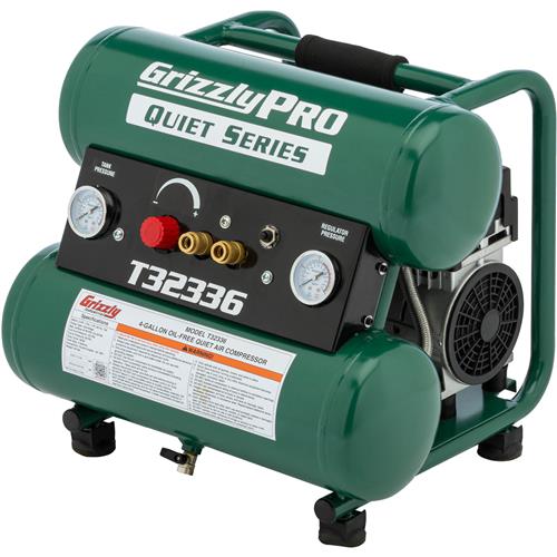

The Grizzly PRO T32336 4-Gallon Oil-Free Quiet Series Air Compressor is designed for portability with increased capacity over small "pancake" compressors. Whether you need a small compressor for your home shop or have a mobile crew using it on location, this unit will exceed your expectations.
It has an operational sound rating of only 67 dB. Similar to a normal conversation, 67 dB is slightly louder than a typical household refrigerator. So, you’ll get not only better safety, but a contractor can walk a client through a jobsite and hold a normal conversation right next to the running compressor.
Compare this with a normal compressor sound rating of 90 dB, which is about equal to a lawnmower. It’s hard to describe just how striking the difference is—you really must hear it to believe it.
The 2 HP motor runs at 1725 RPM with a cut-out pressure of 135 PSI. This compressor delivers 4.5 SCFM at 90 PSI and 5.2S CFM at 40 PSI.
The oil-free double piston pump design provides four times the life of most oil-free compressors, making for cleaner air emissions and lower maintenance costs as well. It also reduces the time needed for the tank to reach maximum pressure vs a single piston.
The T32336 features an easy-access and damage-protected control panel. The panel is home to the overload reset, dual quick connects, tank pressure gauge and output pressure gauge. The compressor comes with non-marring rubber feet to protect your floors.
Like all Grizzly air compressors, the T32336 comes with a 1-year warranty which covers parts and assures the unit is free from factory defects.
The T32336 manual was written by our U.S.-based Technical Documentation Department and is packed with useful information on how to assemble and maintain your portable air compressor pump.

  • Motor: 2 HP, 110V, single-phase, 11A
  • Airflow capacity: 4.5 SCFM @ 90 PSI, 5.2 SCFM @ 40 PSI
  • Maximum air pressure: 140 PSI
  • Cut-out pressure: 135 PSI
  • Cut-in pressure: 105 PSI
  • Duty cycle: 50/50
  • Tank size: 4-Gallon (twin stack)
  • Sound rating: 67 dB
  • Footprint: 15" x 12-1/2"
  • Overall size: 23" x 20" x 17"
  • Approximate shipping weight: 60 lbs.
  • Twin tank design protects motor
  • Oil-free double piston pump design
  • Tank pressure and output pressure gauges
  • Quiet operating
  • Safety valve
  • Air regulator
