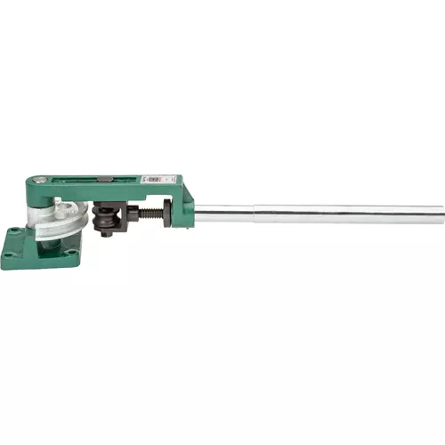

The T32715 Tube Bender Set is designed to bend most common tube sizes on a safe centerline radius.
This tube bender can bend round tube between 3/8" and 7/8" in diameter, and square tube between 3/4" and 1" in diameter.
The set comes with 3/8", 1/2", 9/16", 5/8", 3/4", and 7/8" round dies, as well as 3/4" and 1" square dies.
Anchor the bender to your bench, insert the appropriate die for your needs, and bend away.
Like all Grizzly benders, the T32715 comes with a 1-year warranty which covers parts and assures the unit is free from factory defects.
The T32715 instructions were written by our U.S.-based Technical Documentation Department and is packed with useful information.
The Grizzly Customer Service and Technical Support Teams are also U.S.-based.
SPECIFICATIONS
  • Maximum working width: 7-7/8"
  • Round Tube Capacity: 3/8"–7/8"
  • Square Tube Capacity: 3/4"–1"
  • Maximum Bending Angle: 180°
  • Maximum Bending Capacity: 18-Gauge
  • Approximate shipping weight: 59 lbs.
  • Two-piece handle
  • Hard plastic carrying case
