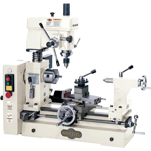

Image for Shop Fox M1018 - Small Combo Lathe / Mill
M1018 Shop Fox Small Combo Lathe / Mill
Hobby or entry-level machinists will not want to pass up this versatile machine. Great for turning, cutting threads, and drilling and milling small projects, this combo lathe is packed with extra add-ons like a 4-way turret tool post, 9-1/2" faceplate, 4" 3-jaw chuck, and a built-in rotating vise. Features a 16-1/2" swing over bed, 11-1/2" swing over saddle, 19-1/4" distance between centers, 3/4" spindle bore, and MT#3 tapers.
Specifications
  • Lathe motor: 3/4 HP, 110V, single-phase
  • Lathe swing over bed: 16-1/2"
  • Lathe swing over saddle: 11-1/2"
  • Mill swing: 12"
  • Distance between centers: 19-1/4"
  • Lathe cross slide travel: 4-1/2"
  • Lathe compound travel: 3"
  • Lathe carriage travel: 14-3/4"
  • Mill spindle travel: 3-1/2"
  • Lathe spindle speeds: 7 @ 160, 300, 375, 470, 600, 870, 1360 RPM
  • Mill spindle speeds: 14 @ 117, 150, 220, 276, 290, 345, 360, 440, 450, 575, 640, 836, 1000, 1300 RPM
  • Spindle bore: 3/4"
  • Lathe spindle taper: MT#3
  • Mill drill chuck taper: MT#3
  • Drawbar thread: 3/8"-16
  • Drilling capacity—steel cast-iron: 7/8"
  • Bed width: 5-1/2"
  • Tailstock barrel taper: MT#3
  • Tailstock barrel travel: 1-1/2"
  • Leadscrew: 7/8"-6 TPI
  • Longitudinal feeds: 8 @ 0.002"-0.0069"
  • Max. tool bit size: 1/2"
  • Thread range (inch): 27 @ 8-120 TPI
  • Thread range (metric): 18 @ 0.2-3.0mm
  • Includes 1/2" drill chuck, 2 dead centers, 4" 3-jaw chuck, 4-way tool post, 5" back plate, 9-1/2" faceplate, change gears, MT#3 chuck arbor, hex & combo wrenches
  • Overall size: 42"L x 23"W x 35"H
  • Approximate shipping weight: 478 lbs.
  • Two-year warranty!!
