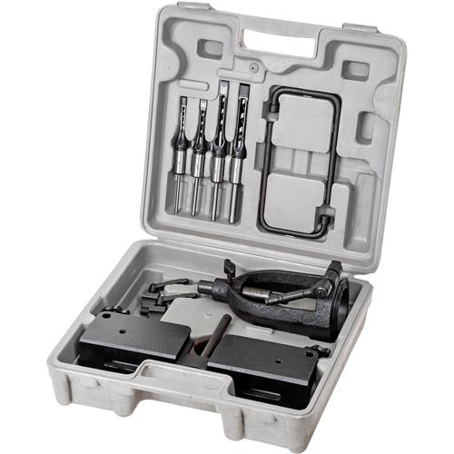

Shop Fox D4031 Mortising Attachment Kit for Drill Presses
Tired of struggling to create precise mortises for your woodworking projects?
Imagine being able to create professional-grade mortises in a fraction of the time it would take using traditional methods.
Adding the D4031 Mortising Attachment Kit will save you time and energy, allowing you to focus on the creative aspects of your work.
Featuring 1/4", 5/16", 3/8" and 1/2" chisels, this kit will help you produce “old school” mortise and tenon joints and is versatile for a variety of wood types.
With its variety of interchangeable bushings, the D4031 will fit just about any drill press for boring precision mortises.
The entire kit includes three two-piece bushings, three split bushings, a cast-iron chisel holder and fence, a hold down assembly, a quill alignment pin, and a carrying case.
Don't waste any more time on tedious mortising.
Just match your drill press quill diameter to the nearest ID bushing dimension.
Bushing sizes include: 2.945" O.D. x 2.600" I.D., 2.600" O.D. x 2.366" I.D, 2.366" O.D. x 2.170" I.D., 2.600" O.D. x 2.000" I.D., 2.600" O.D. x 1.880" I.D. and 2.600" O.D. x 1.570" I.D.
The D4031 comes with a Shop Fox 2-year warranty which assures the set is free from factory defects.
The manual was written by our U.S.-based Technical Documentation Department and is packed with useful information.
The Shop Fox Customer Service and Tech Support Teams are U.S.-based.
FITS:
  • Shop Fox W1680 17" Floor Model Drill Press
  • Shop Fox M1039 20" Floor Drill Press (also requires G9716)
  • Grizzly G0485 13" Bench Drill Press
  • Grizzly G0491 13" Floor Model Drill Press
  • Grizzly G0794 14" Floor Drill Press with Laser and DRO
  • Grizzly G7943 14" Heavy-Duty Benchtop Drill Press
  • Grizzly G7944 14" Heavy-Duty Floor Drill Press
  • Grizzly G7947 17" Floor Drill Press (also requires G9716)
  • Grizzly G7948 20" Floor Drill Press (also requires G9716)
  • Grizzly T33901 14" Benchtop Drill Press
  • Grizzly T33902 14" Floor Drill Press
  • Grizzly T33903 17" Floor Drill Press
  • Grizzly T33904 20" Floor Drill Press
  • Grizzly T33959 15" Benchtop Variable-Speed Drill Press
  • Grizzly T33960 15" Floor Variable-Speed Drill Press
  • Grizzly T33961 17" Floor Variable-Speed Drill Press
  • Grizzly T33962 16" Benchtop Variable-Speed Drill Press
  • Delta 11-990
  • Delta 14-070
  • Delta 17-900
  • Delta 11-090
  • Jet JDP-14MF
  • Jet JDP-17M
  • Jet JDP-17MF
Note: Not recommended for use with 8" drill presses or radial drill presses.
