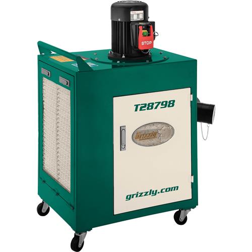

T28798 1-1/2 HP Metal Dust Collector
Keep your fabrication shop clean while reducing levels of harmful fumes.
The Grizzly T28798 Metal Dust Collector features a multi-stage filtration system with three 15-1/4" x 19-1/4" filters with 30, 5, and 1-micron ratings.
Operate up to two machines at a time thanks to the 650 CFM of airflow capacity with 10.8" of static pressure through the dual 4" dust ports.
Large grinding dust and cutting chips are deposited in the removeable clean-out drawer.
Metal dust collectors are specifically designed to help reduce airborne dust levels in the shop.
When properly used and maintained, a metal dust collector will help keep your shop cleaner and reduce the risk of dust inhalation or dust related fire/explosion.
Not for wood dust collection.
Like all Grizzly machines, the T28798 comes with a 1-year warranty which covers parts and assures the unit is free from factory defects.
The T28798 manual was written by our U.S. based Technical Documentation Department and is packed with useful information. The complete and easy-to-read manual makes it easier to assemble and maintain your dust collection system.
The Grizzly Customer Service and Technical Support Teams are U.S. based. Parts for your machine may be available online and shipped from the Grizzly parts warehouse in Springfield, MO.
  • Motor: 1-1/2 HP, 240V, single phase, 9A
  • Airflow capacity: 650 CFM
  • Maximum static pressure (at 0 CFM): 10.8"
  • Filter size: 19-1/4" x 15-1/4"
  • 1st stage filter: 30-microns
  • 2nd stage filter: 5-microns
  • 3rd stage filter: 1-micron
  • Impeller size: 12-3/4"
  • Main inlet size: 6"
  • Number of adapter inlets: 2
  • Adapter inlet size: 4"
  • Sound rating: 82 dB
  • Maximum material collection capacity: 1.22 cu.ft.
  • Footprint: 20" x 28-1/2"
  • Overall size: 20" W x 28-1/2" D x 43" H
  • Approximate shipping weight: 199 lbs.
  • 3-stage filter system: stainless steel, active carbon, and pleated micro filter
  • Aluminum impeller
  • Toggle ON/OFF switch
  • Dual 4" inlets for two machines
  • Casters for easy mobility
  • Removable clean out drawer
