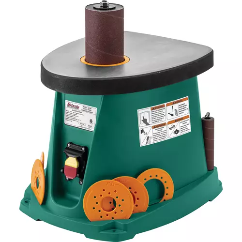

G0739 Benchtop 1/2 HP Oscillating Spindle Sander
Sand nearly any curve for a fraction of the cost of a floor spindle sander.
Don't let the compact size fool you. The G0739 Benchtop 1/2 HP Oscillating Spindle Sander with a cast-iron table will handle just about any job you throw at it.
Sand inside and outside curves of all shapes and sizes with the six included 4-1/2" long sanding sleeves, ranging in size from 1/2" to 3" in diameter.
The oscillating movement of the spindle sands workpieces more efficiently. Versus non-oscillation sanders, these machines burn less, remove more, and wear the sandpaper less.
Your sanding sleeves, drums, table inserts, and spindle washers will never be far out of reach with the built-in storage, designed to keep all your components organized and handy.
The compact size of the machine makes it portable for moving around a job site or off your workbench when you need the space.
The paddle safety switch with removable key helps prevent unauthorized use or accidental startups.
The G0739 manual was written by our U.S.-based Documentation Department and is packed with useful information. The complete and easy-to-read manual makes it easier to assemble and maintain your sander.
CSA certified
  • Motor: 1/2 HP, 120V, single-phase, 3.5A
  • Table size: 11-1/2" x 15"
  • Spindle speed: 2000 RPM
  • Spindle stroke: 5/8"
  • Spindle oscillations: 58 SPM
  • Spindle diameter: 1/2"
  • Sanding drum length: 4-1/2"
  • Sanding drum diameters: 3/4", 1", 1-1/2", 2", 3"
  • Dust port size: 1-1/2"
  • Footprint: 14" x 15-1/2"
  • Overall dimensions: 15-9/16" W x 14-1/8" D x 17" H
  • Approximate shipping weight: 33 lbs.
INCLUDES:
  • (5) Rubber sanding drums: 3/4", 1", 1-1/2", 2", 3" diameter
  • (6) 80-grit sanding sleeves: 1/2", 3/4", 1", 1-1/2", 2", 3" diameter
  • (6) Table inserts
  • (3) Spindle washers
  • Spindle wrench
We offer U.S.-based customer service and technical support to get your questions answered and help keep your equipment running in top condition. And to ensure your satisfaction, the G0739 comes with a 1-year warranty.
