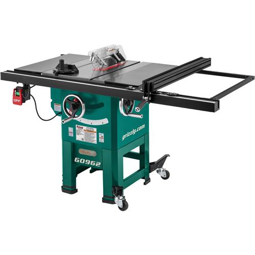

Grizzly G0962 - 10" 2 HP Open-Stand Hybrid Table Saw

  • Motor: 2 HP
  • Tablesaw type: Hybrid
  • Blade size: 10 in.
  • Maximum cutting height @ 90deg: 3-1/4 in.
  • Maximum cutting height @ 45deg: 2-1/4 in.
  • Maximum ripping capacity - right: 30 in.
  • Table type: Cast Iron
  • Overall table size: 40-1/4 in. x 27 in.
  • Shipping weight: 297 lbs.
G0962 10" 2 HP Open-Stand Hybrid Table Saw
An entry-level table saw with the cutting capacity and table size of larger cabinet saws.
This open-stand hybrid table saw offers the power and features you need to keep up with your production schedule. The single-phase motor is prewired for 120V, and the hybrid design provides exceptional cutting capacities to guarantee professional results.
The precision-ground cast-iron table provides for smooth cutting action, and the cabinet-mounted cast-iron trunnions reduce vibration and improve T-slot miter and blade alignment. The easy-glide fence system allows for fence adjustability and removal based on your specific project needs.
To keep up with your high-volume cutting, the saw is equipped with a bottom-facing 4" dust port that provides exceptional dust control. In addition to power and cutting efficiencies, this lightweight saw with a built-in mobile base is easy to move around your shop, for the ultimate in convenience.
With all of these features, you will find this is the best hybrid table saw for the money.
  • Motor: 2 HP, 120V/240V (prewired for 120V), single-phase, 15A/7.5A
  • Rip capacity: 30" right, 15" left of blade
  • Max. depth of cut @ 90°: 3-1/4"
  • Max. depth of cut @ 45°: 2-1/4"
  • Table size: 40-1/4" W x 27" D
  • Distance from front of table to center of blade: 15-1/2"
  • Floor-to-table height: 35-3/4"
  • Arbor diameter: 5/8"
  • Arbor speed: 3450 RPM
  • Maximum width of dado: 13/16"
  • Footprint: 21" x 19-1/2"
  • Overall dimensions: 64" W x 40-1/2" D x 36" H
  • Approximate shipping weight: 297 lbs.
  • Built-in mobile base
  • Precision-ground cast-iron table with powder-coated steel extension wings
  • Easy-glide fence system
  • Powerful dual-voltage 2 HP motor
  • Cast-iron trunnions
  • Enclosed cabinet top with 4" dust port
