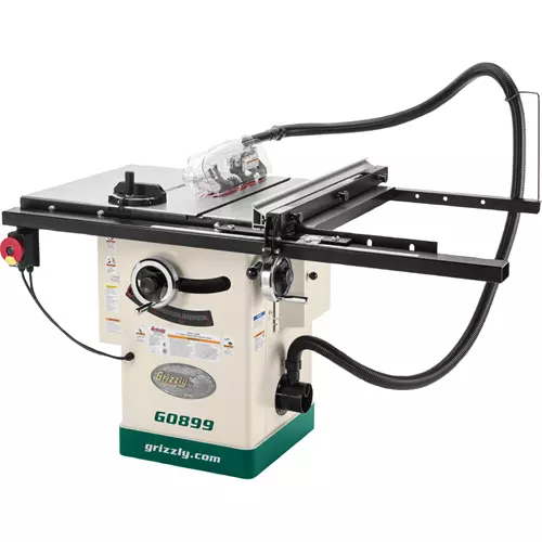

G0899 10" 2 HP 115V/230V Cabinet Table Saw
The perfect balance of power, precision, and price in a table saw.
We took our rock-solid 10" table saw platform with a powerful 2 HP TEFC motor and paired it with the most efficient dust collection system we could design.
The internal dust shroud surrounds the bottom-side of the blade for efficient dust collection. The clear blade guard features built-in dust collection off the top of the blade. Combined, these two designs meet and send dust through the 4" dust port.
This saw can be plugged into 20-amp household power thanks to the prewired 5-20 plug for 115-voltage, and can be rewired to run 230V for improved motor performance resulting in increased torque, smoother operation, and lower energy costs.
For added durability, G0899 has a cabinet-mounted cast-iron trunnion, a heavy-duty fence, and a precision-ground cast-iron table.
The micro-adjustable easy-glide, two-position fence system quickly adjusts to rip narrow workpieces.
The easy-to-reach paddle switch has a disabling key as an added safety feature to keep the machine from running when not in use.
The complete and easy-to-read G0899 manual was written by our U.S.-based Technical Documentation Department and is packed with useful information.

  • Motor: 2 HP, 115V/230V (prewired for 115V), single-phase, 16A/8A
  • Rip capacity: 31-1/2" right, 11-3/8" left of blade
  • Max. depth of cut @ 90°: 3-1/8"
  • Max. depth of cut @ 45°: 2-1/8"
  • Overall table dimensions: 40-1/8" W x 27" D
  • Distance from front of table to center of blade: 16-1/4"
  • Floor-to-table height: 34-1/4"
  • Arbor diameter: 5/8"
  • Arbor speed: 4000 RPM
  • Max. width of dado: 13/16"
  • Main dust port size: 4"
  • Footprint: 19-1/2" x 20-1/2"
  • Overall dimensions: 66" W x 40" D x 48" H
  • Approximate shipping weight: 450 lbs.
  • Cast-iron tables and trunnions for long-lasting durability
  • Micro-adjustable easy-glide fence system with narrow rip attachment
  • Fully-enclosed blade guard with dust port
  • Chromed cast-iron handwheels
  • Heavy-duty miter gauge
  • Poly-V drive belt for reduced noise/vibration
  • Deluxe 2-position aluminum rip fence
  • 1-year limited warranty
