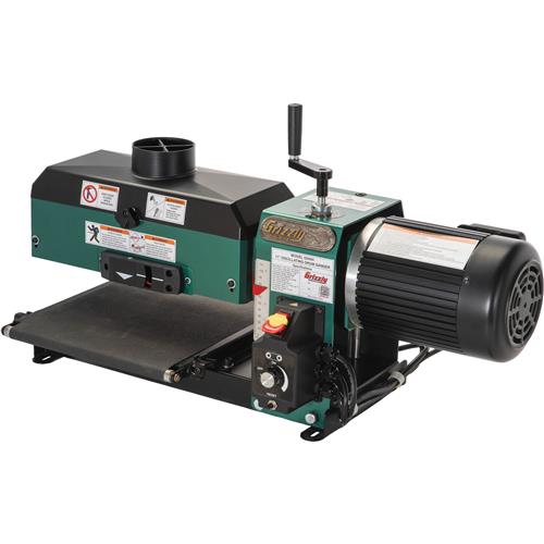

G0404 11" Benchtop Oscillating Drum Sander
Slash sanding time and produce smooth, fine finishes with this versatile oscillating drum sander.
Simplify sanding processes and get flawless results with the efficiency of oscillating motion and the convenience of benchtop operation! This drum sander's side-to-side oscillating action minimizes sandpaper clogging and heat buildup, ensuring a high-quality finish without ruining your workpieces. Also, if you need sanding without oscillation for highly figured woods or unique projects, it's easy to turn this setting off for added control and versatility.
Designed to meet the needs of professional woodworkers, hobbyists, and even beginners, this oscillating drum sander is powered by a reliable 1 HP motor. This time-saving machine includes a variable-speed conveyor so you can modify the feed speed based on your material type, paired with a depth gauge and indicator for accurate depth adjustments.
Get professional-level woodworking results every time with this oscillating sander, regardless of your skill level! Additional features include a user-friendly hook-and-loop drum for quick sandpaper changes and a standard dust port for easy connection to a dust collector.
FEATURES & BENEFITS:
- Oscillating Drum: The 5" sanding drum reduces total sanding time and enhances results with an efficient 29 oscillations per minute.
 - Dual-Sanding Modes: Switch between oscillating and non-oscillating modes based on workpiece type and finish preference.
 - 1 HP Motor: A 1 HP, 110V, single-phase, 1720 RPM motor offers consistent performance for every sanding project.
 - Variable-Speed Sandpaper Conveyor: Adjustable speed of 0-15 FPM provides exacting control of your feed speed.
 - Depth Gauge & Indicator: Ensures precision for sanding depth and consistent, repeatable results.
 - Hook & Loop Drum: Simplifies sandpaper changes and reduces downtime – no more scraping to remove adhesive sandpaper!
 - 4" Dust Collection Port: Easily attach a dust collector to minimize debris in your shop.
- Motor: 1 HP, 110V, single-phase, 11A
 - Conveyor motor: 25W, 0.3A
 - Max. board thickness: 3"
 - Max. board width: 22"
 - Min. board thickness: 1/8"
 - Min. board length: 2-3/8"
 - Sandpaper speed: 2250 FPM
 - Conveyor feed rate: 0-15 FPM
 - Drum size: 5" Diameter, 12" length
 - Sandpaper: H & L
 - Dust port diameter: 4"
 - Footprint: 11-1/2" x 22"
 - Overall dimensions: 33-1/2" W x 17" D x 18" H
 - Approximate shipping weight: 100 lbs.
Maximize sanding efficiency with this precision-engineered, hassle-free benchtop oscillating drum sander that can sand a 22" board in two passes!
