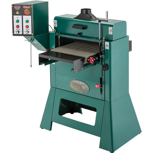

G0400 17" Brush Sander
A versatile brush sander for masterful finishes.
Precision, power, and versatility. The G0400 17" Brush Sander delivers all three, making it the ideal tool for serious woodworkers and cabinet shops looking to enhance production capabilities. Unlike traditional drum or belt sanders, this brush design offers unmatched flexibility for sanding irregular shapes, profiles, and delicate surfaces. Whether you're reclaiming lumber, smoothing workpieces between coats of finish, profile sanding custom moldings, or deburring and polishing metal, this machine has you covered.
The G0400 comes equipped with a durable 240-grit silicon carbide-impregnated brush with an extremely long lifespan for less downtime and more sanding. The brush is ideal for scuff sanding full-face panel doors, drawer fronts, thin veneers, and molding, and it can even smooth workpieces between coats of primer, paint, stain, or lacquer.
FEATURES and BENEFITS:
  • Powerful 1-3/4 HP Motor: Delivers ample power for efficient and effective sanding operations, ensuring consistent performance even with heavy-duty tasks.
  • Variable-Speed Conveyor: Precisely adjust the feed rate for different materials or sanding strengths.
  • Variable-Speed Brush with Digital Readout: Dial in brush speed for precise adjustments to suit different sanding needs and materials.
  • Variable Frequency Drive: VFD for smooth, high-torque variable speed using single-phase power.
  • 240-Grit Silicon Carbide-Impregnated Brush: As the bristle wears down it exposes new abrasive, giving the brush extended durability.
  • Quick-Release Belt Tension Lever: Allows for quick and easy replacement of brushes and drums. Imagine swaps in less than 3 minutes!
  • Versatile Compatibility with Multiple Brush Types: From metal polishing to final sanding, this machine can handle it all, thanks to its compatibility with optional flap and metal wire brushes or a hook-and-loop sanding drum.
  • Sand Thin Stock: The rubber pressure rollers prevent kickback and work with materials as thin as 1/32"!
  • LED Lights: Strategically placed lights illuminate the pressure roller and workpiece for optimal visibility. The lights turn red when the brush is activated.
  • Built-in Storage for Extra Brushes: Keep your workspace organized and efficient.
User-friendly features enhance convenience, reduce setup time, and improve workflow efficiency.
Crafted with durability and reliability in mind, the G0400 is built to withstand the demands of businesses that can’t afford downtime. Its robust construction and high-quality materials ensure long-lasting performance, so you can focus on your projects without worrying about your equipment.
  • Required power source: 110V, single-phase, min. 20A circuit
  • Sanding motor: 1-3/4 HP, 220V, (with voltage converter for 110V power)
  • Feed motor: 1/5 HP
  • Stock width: 1"–17" T
  • Stock thickness: 1/32"–3"
  • Brush head diameter range: 5–8"
  • Brush head speed: Variable, 400–1700 RPM
  • Brush head type: Nylon, 240-grit
  • Conveyor feed rate: Variable, 2–12 FPM
  • Conveyor belt dimensions: 17" W x 36-3/8" L
  • Floor to table height: 32–36"
  • Dust port size: 4"
  • Footprint: 34" x 20"
  • Overall dimensions: 37" W x 37-1/2" D x 50" H
  • Approximate shipping weight: 320 lbs.
Need help? We offer U.S.-based customer service and technical support to get your questions answered and help keep your equipment running in top condition. And to ensure your satisfaction, the G0400 comes with a 1-year warranty.
