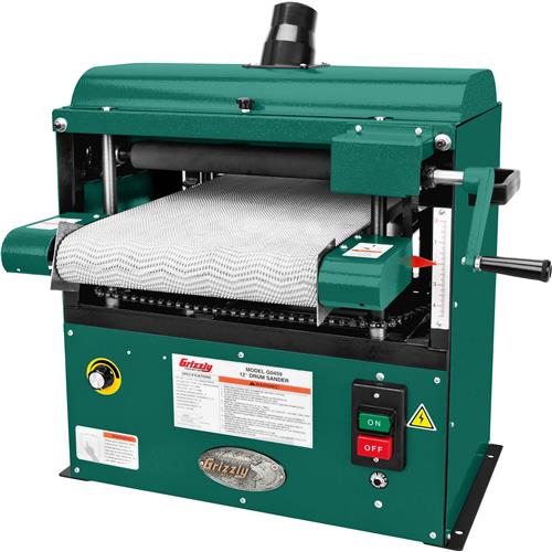

G0459 12" 1-1/2 HP Baby Drum Sander
A drum sander sized for workbenches or sturdy tool stands.
The G0459 1-1/2 HP Baby Drum Sander packs a wallop when it comes to sanding wood up to 12" wide.
This machine comes equipped with a 1-1/2 HP sanding motor to spin the 4" sanding drum 2127 FPM and a 2.5–17.3 FPM variable-speed conveyor motor.
The correct speed to use depends on the type of stock you are using (hardwood vs. softwood) and the stage of finish you are at with that workpiece.
Changing the sandpaper is easy and straightforward. Simply open the top cover for unobstructed access to the easy-to-change, hook-and-loop sandpaper. Replacement sanding rolls are available.
A gear-drive table elevation handwheel allows you fine-tune your finish.
A steel dust scoop combined with a 2-1/2" dust port maximizes dust collection efficiency.
The G0459 manual was written by our U.S.-based Technical Documentation Department and is packed with useful information. The complete and easy-to-read manual provides full instructions on how to assemble and maintain your sander.
CSA certified
SPECIFICATIONS
- Sanding motor: 1-1/2 HP, 115V, single-phase, 13A
- Conveyor motor: 1/8 HP, 0.3A
- Sanding drum size: 4"
- Drum surface speed: 2127 FPM
- Maximum stock dimensions: 12" W x 3-1/2" T
- Minimum stock dimensions: 8" L x 1/8" T
- Conveyor feed rate: Variable, 2.5–17.3 FPM
- Conveyor belt dimensions: 12-1/4" W x 49-3/4" L
- Sandpaper size: 3" x 70" Hook and loop
- Footprint: 22-1/4" x 12"
- Dust port size: 2-1/2"
- Overall dimensions: 27" W x 24" D x 27" H
- Approximate shipping weight: 166 lbs.
FEATURES
- Steel dust hood maximizes dust collection efficiency
- Gear-driven table elevation ensures perfect control
- Two adjustable pressure rollers
- Thickness scale
- Independent variable-speed conveyor motor
- Industrial-duty conveyor belt
- Side handles for portability
We offer U.S.-based customer service and technical support to get your questions answered and help keep your equipment running in top condition. And to ensure your satisfaction, the G0459 comes with a 1-year warranty.
