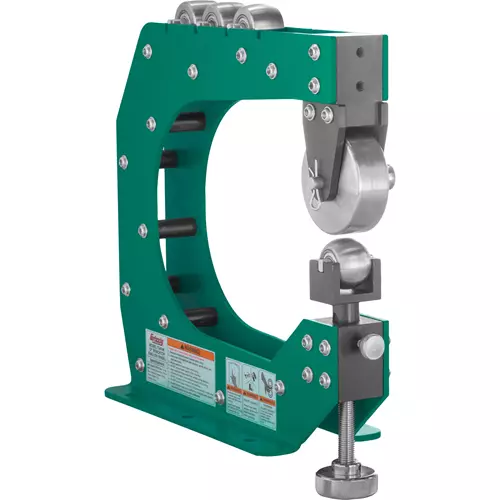

T34346 12" Benchtop English Wheel
Compact English Wheel with Dual-Position Upper Wheel for Custom Metal Shaping
Form sheet metal into smooth seamless contours for motorcycle tanks and fenders, autobody panel repairs, metal sculpture and more!
This English wheel's smaller size doesn't impact performance – get the professional shaping results you want with the convenience of a reduced footprint for small spaces.
Heavy-duty, durable construction minimizes vibration and movement, and all-metal handwheels provide a comfortable grip and allow for simple adjustments.
The dual-position upper wheel and the smaller lower anvil wheel combine to give you exacting control over the curve of each workpiece.
This benchtop English wheel is an affordable equipment choice for automotive restoration, basic sheet metal fabrication, and even artistic pieces that require compound curves and contoured surfaces.
FEATURES & BENEFITS:
  • Compact Design: Achieve the same quality and precision results as with much larger English wheel models.
  • Rigid Frame: Robust construction ensures stability and longevity, so you can work with confidence on metal-shaping tasks.
  • All-Metal Handwheels: Smooth adjustment and control give the accuracy you need with effortless movement.
  • Dual-Position Upper Wheel: Gives greater versatility during operation – easily switch between wheel positions based on each project's needs.
  • Affordability: Cost-effective choice for beginning users or professionals looking for a reliable secondary tool.
  • Throat depth: 12"
  • Mild steel capacity: 16-Gauge
  • Aluminum/copper capacity: 14-Gauge
  • Upper wheel diameter: 3-13/16"
  • Upper wheel contour: Flat
  • Lower anvil wheel diameter: 1-7/8"
  • Lower anvil wheel contours: 1", 2", 3", and 5" Radius
  • Overall dimensions: 5-1/2" W x 17-1/2" D x 16" H
  • Approximate shipping weight: 43 lbs.
Fabricate complex metalworking designs with the T34346 12" Benchtop English Wheel!
