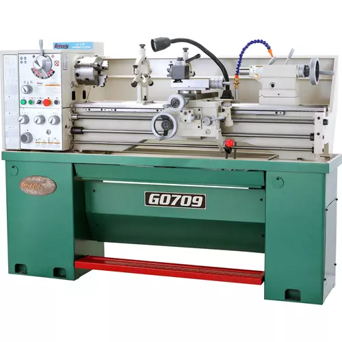

G0709 14" x 40" Gunsmith Gearhead Metal Lathe
A powerful, feature-packed lathe designed for extended production.
The G0709 14" x 40" Gunsmithing Lathe comes with features typically not found on standard lathes, such as high-precision NSK bearings, extra-large 1-9/16" spindle bore and a "spider" mount system.
The spider mount system has four brass-tipped screws that stabilize long shafting and rifle barrels through the outboard end of the spindle.
Supplied with a 2 HP motor, the 8-speed gearhead of the G0709 produces spindle speeds from 70-2000 RPM.
The tailstock lock system features a drive hub, which allows you to use a 1/2” torque wrench to clamp the tailstock in place at a pre-determined torque setting. This ensures consistent draw-down alignment every time, even with multiple lathe operators using the machine.
The G0709 features a foot brake that also acts as a safety device and can bring the machine to an instant stop.
The G0709 also comes with a D1-5 spindle, a 200 series quick change tool post, flood coolant system, LED work light, and a pull-out chip tray.
Like all Grizzly gunsmithing lathes, the G0709 comes with a 1-year warranty covering parts and assuring the unit is free from factory defects. (Consumables are not covered by the warranty.)
The G0709 manual was written by our U.S.-based Documentation Department and is packed with useful information. The complete and easy-to-read manual makes it easier to assemble and maintain your lathe.
The Grizzly Technical Support team is U.S.-based. Parts and accessories for the lathe may be available online and shipped from the Grizzly parts warehouse in Springfield, MO.
