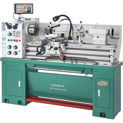

G0824 14" x 40" Gunsmith Lathe with 2" Spindle Bore
A bigger bore allows for turning bigger barrels.
The G0824 14" x 40" Gunsmith Lathe has a huge 2" spindle bore, the largest of any of our 14" x 40" lathes. The extra-large spindle bore is what makes it perfect for gunsmithing barrels.
What makes the G0824 a "gunsmithing" lathe is that it comes with features typically not found on standard lathes, such as the extra-large spindle bore, a "spider" mount system and high-precision bearings.
The spider is especially designed for supporting gun barrels during chambering operations; however, it is a great support option for almost any long workpiece that extends through the outboard side of the spindle.
The G0824 includes a DRO, so accuracy and precision are ensured!
This 14" x 40" Gunsmith Lathe has an 8-speed gearhead for spindle speeds from 70–2000 RPM.
The G0824 includes other exceptional equipment you’ll need to get up and running including: a D1-5 camlock spindle, 200-series quick-change tool post, flood coolant system, LED work light, pull-out chip tray, ball-bearing steady and follow rests, steel stand, and safety foot brake!
