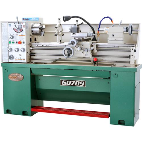

G0709 14" x 40" Gunsmith Gearhead Metal Lathe
A powerful, feature-packed lathe designed for extended production.
The G0709 14" x 40" Gunsmithing Lathe comes with features typically not found on standard lathes, such as high-precision NSK bearings, extra-large 1-9/16" spindle bore and a "spider" mount system.
The spider mount system has four brass-tipped screws that stabilize long shafting and rifle barrels through the outboard end of the spindle.
Supplied with a 2 HP motor, the 8-speed gearhead of the G0709 produces spindle speeds from 70-2000 RPM.
The tailstock lock system features a drive hub, which allows you to use a 1/2” torque wrench to clamp the tailstock in place at a pre-determined torque setting. This ensures consistent draw-down alignment every time, even with multiple lathe operators using the machine.
The G0709 features a foot brake that also acts as a safety device and can bring the machine to an instant stop.
The G0709 also comes with a D1-5 spindle, a 200 series quick change tool post, flood coolant system, LED work light, and a pull-out chip tray.

SPECIFICATIONS
  • Motor: 2 HP, 220V, single-phase, 10A
  • Swing over bed: 14"
  • Distance between centers: 40"
  • Swing over saddle: 13-13/16"
  • Swing over cross slide: 8-13/16"
  • Spindle bore: 1.57" (40mm)
  • Spindle nose taper: MT#5
  • Spindle nose: D1-5 Camlock
  • Spindle speeds: 8, 70-2000 RPM
  • Carriage travel: 36"
  • Cross slide travel: 6-11/16"
  • Tailstock barrel taper: MT#3
  • Tailstock barrel travel: 3-15/16"
  • Footprint: 70-3/8" x 15-3/4"
  • Overall dimensions: 71-1/2" L x 26-3/16" W x 52" H
  • Approximate shipping weight: 1550 lbs.
FEATURES
  • Spider mount system for stability
  • Easy-to-use lever controls
  • Hardened and ground cast-iron bed
  • Cuts 4-112 Standard TPI and 0.1-7 Metric
  • Cuts LH threads
  • On/off reverse switch on carriage
  • Socket for tailstock lock
  • Cast aluminum gear cover
STANDARD EQUIPMENT
  • 6" 3-Jaw chuck with reversible jaws
  • 8" 4-Jaw chuck with independent jaws
  • 11" face plate
  • Steady rest/follow rest
  • Full length splash guard
  • Quick change tool post with 2 tool holders
  • (2) MT#3 dead centers (1 carbide tipped)
  • (1) MT#3 live center
  • (1) MT#5 - MT#3 sleeve
  • Pull-out chip pan
  • 1/2" drill chuck w/ MT#3 arbor
  • Toolbox
