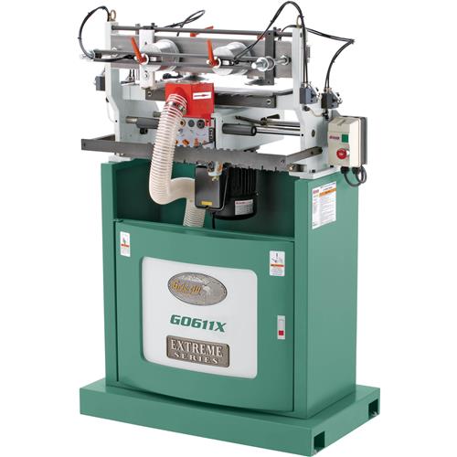

G0611X 16-1/2" Extreme Series Dovetail Machine
Produce strong and attractive half-blind dovetail joints at scale.
If you're wanting to upgrade from producing dovetails with a dovetail jig, this dovetail machine will quickly pay for itself!
The G0611X features pneumatic clamps for quickly loading workpieces and a 4-sided template for cutting 1", 1-1/2", 2", and 2-1/2" dovetails.
With the ability to cut two joints at a time, the G0644X can produce a 4-sided drawer in under two minutes if the boards are prepared properly.
Also spindle heads are micro-adjustable to give you complete control of dovetail "fit."
The H9388 replacement dovetail bits are available when your stock bits start getting dull.
- Motor: 1 HP, 110V/220V (prewired 220V), single-phase, 10A/5A
- Minimum circuit size: 15A @ 120V, 15A @ 240V
- Number of spindles: 1
- Spindle speed: 18,500 RPM
- Dovetail bit: 10° angle x 5/8" long
- Dovetail shank: 12mm
- Maximum dovetail height: 3/4"
- Minimum dovetail height: 3/16"
- Maximum thickness: 2-3/8"
- Minimum thickness: 13/32"
- Maximum stock size: 59" long x 16-1/2" wide
- Minimum stock size: 7-7/8" long x 2-3/8" wide
- Table size: 24" x 7-3/4"
- Floor to table height: 46-7/16"
- Footprint: 37" W x 21-1/4"
- Overall size: 38-5/8" W x 26-1/2" x 56-7/8" H
- Approximate shipping weight: 539 lbs.
- Micro-adjustable spindle head
- Dual pneumatic clamping system
- Four-way dovetail template
- Cast aluminum, spring-loaded carriage
- Precision-milled cast-iron table frame
- Hardened and ground chrome steel slide ways
- Quick air-cylinder clamp, air filter/regulator/lubricator with pressure gauge
- Magnetic switch with thermal overload protection
- Ball-bearing linear guides
- Workpiece stops
- 4" dust port
The G0611X manual was written by our U.S.-based Technical Documentation Department and is packed with useful information. The complete and easy-to-read manual makes it easier to assemble and maintain your dovetail machine.
We offer U.S.-based customer service and technical support to get your questions answered and help keep your equipment running in top condition. And to ensure your satisfaction, the G0611X comes with a 1-year warranty.
Please note: To accommodate the machine's footprint, extension bars may be necessary when using a mobile base.
