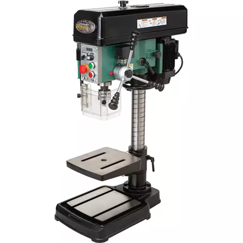

T33962 16" Benchtop Variable-Speed Tapping Drill Press
A specialized drill press with tapping capability to streamline threading processes.
This benchtop drill press provides the additional functionality you need to cut your desired thread patterns, offering a 1/2" tapping capacity.
With two variable-speed spindle speed ranges and a digital readout, it is simple to adjust the speed based on your specific needs. The spindle has auto reverse for tapping functions.
The 360° headstock makes positioning easy, headstock height is easily adjustable, and the cast-iron base gives stability during use.
The Class II laser gives the precision required for every project by preventing alignment mistakes – no guesswork involved.
A built-in LED work light below the headstock of this variable-speed drill press provides helpful extra illumination.
Rack-and-pinion table elevation control allows for effortless, precise adjustments based on your material thickness.
The square chuck safety guard comes with a micro switch that shuts the drill press off if the guard is opened. The clear chip guard protects the user from debris.
It also offers a belt cover safety switch for additional safety during operation.
  • Required power source: 120V, single-phase, min. 15A circuit
  • Motor: 3/4 HP, 120V
  • Swing: 16"
  • Spindle taper: MT#2
  • Spindle speed: Variable, 0-600, 0-2100 RPM
  • Max. distance from spindle to table: 12-9/16"
  • Drill chuck: 5/8", JT3 keyed
  • Drilling capacity: 9/16" steel
  • Tapping capacity: 1/2"
  • Table size: 9-3/4" x 11-1/8"
  • Table tilt: 45° left/right
  • Table swivel around column: 360°
  • Footprint: 14" x 20-1/2"
  • Overall dimensions: 16" W x 28-1/2" D x 39-1/2" H
  • Approximate shipping weight: 204 lbs.
  • Two variable-speed spindle speed ranges
  • Reversible spindle rotation
  • Adjustable headstock height
  • Adjustable Class II laser guide
  • Spindle speed digital readout
  • Rack-and-pinion table elevation control
  • Built-in LED work light
  • Square chuck guard with micro switch
  • Clear chip guard
  • Belt cover safety switch
