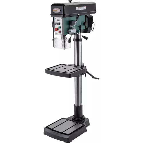

T33963 20" Floor Variable-Speed Tapping Drill Press
Achieve precision when tapping threaded holes with this floor drill press.
The T33963 provides the additional functionality you need to cut your desired thread patterns, offering a 1/2" tapping capacity.
With two variable-speed spindle speed ranges and a digital readout, it is simple to adjust the speed based on your specific needs.
For convenience, the spindle rotation can be reversed, and you can easily adjust the headstock height. The 360° headstock makes positioning easy, and the cast-iron base gives stability during use.
The Class II laser gives the precision required for every project by preventing alignment mistakes – no guesswork involved.
A built-in LED work light below the headstock of this variable-speed drill press provides helpful extra illumination.
Rack-and-pinion table elevation control allows for effortless, precise adjustments based on your material thickness.
The square chuck safety guard comes with a micro switch that shuts the drill press off if the chuck is opened. The clear chip guard protects the user from debris.
It also offers a belt cover safety switch for additional safety during operation.
  • Required power source: 120V, single-phase, min. 20A circuit
  • Motor: 1 HP, 120V
  • Swing: 20"
  • Spindle taper: MT#3
  • Spindle speed: Variable, 0-600 RPM (Low) and 0-2100 RPM (High)
  • Drill chuck: 5/8", JT3 keyed
  • Tapping capacity: 1/2"
  • Table size: 15" x 16-1/4"
  • Table swivel around column: 360°
  • T-slots: (x2) 9/16", 7-5/8" on center
  • Footprint: 26" x 17-1/2"
  • Overall dimensions: 22" W x 33-1/2" D x 70" H
  • Approximate shipping weight: 496 lbs.
  • Two variable-speed spindle speed ranges
  • Reversible spindle rotation
  • Adjustable headstock height
  • Adjustable Class II laser guide
  • Spindle speed digital readout
  • Rack-and-pinion table elevation control
  • Built-in LED work light
  • Square chuck guard with micro switch
  • Clear chip guard
  • Belt cover safety switch
  • Cast-iron base with two 9/16" T-slots
