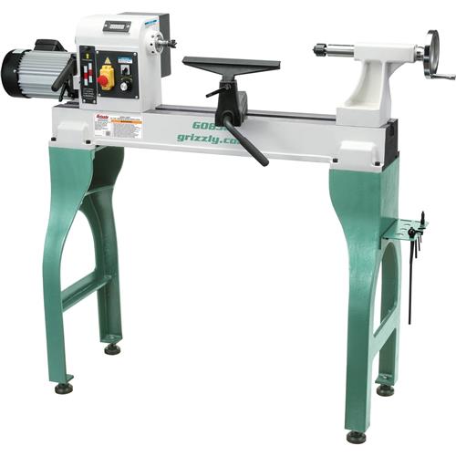

G0838 16" x 24" Variable-Speed Wood Lathe
Don't let its small size fool you, this stout machine has plenty to offer.
Bring home the functionality and features of a much larger lathe with the compact G0838 16" x 24" Variable-Speed Wood Lathe.
The headstock slides along the precision-ground cast-iron bed and can be locked in place on the tailstock side for outboard turning of much larger pieces.
This machine is a bowl-turner's dream!
The optional T28372 Bed and Tool Post Extension provides an incredible 28" swing over the bed extension. The extension can also be mounted to the end of the lathe bed for a total of 47" between centers.
ETL certified
  • Required power source: 220V, single-phase, min. 15A circuit
  • Motor: 2 HP, 220V
  • Swing over bed: 16"
  • Swing over tool rest base: 11-1/2"
  • Spindle taper: MT#2
  • Spindle thread size: 1" x 8 TPI RH
  • Tailstock taper: MT#2
  • Spindle bore: 3/8"
  • Spindle speeds: Variable, 100–1300 RPM (low); 150–2900 RPM (high)
  • Tool rest width: 12"
  • Tool rest post diameter: 1"
  • Footprint: 42-1/2" x 16"
  • Overall dimensions: 60-1/2" w x 23-1/2" D x 48" H
  • Approximate shipping weight: 388 lbs.
  • Heavy-duty cast-iron bed and legs ensure stability and minimize vibration
  • Digital spindle speed tachometer
  • Quick, easy, and secure cam-lock headstock and tailstock adjustment
  • Headstock can be positioned anywhere along the bed
  • Spindle indexes at 10° and 30° for precise, evenly spaced marking, drilling, carving, etc.
  • Built-in, easy access tool holder
  • 12" tool rest with 1" post
  • Cam-lock/release levers for tailstock and headstock
  • Forward and reverse turning capacity
INCLUDES:
  • 6" Faceplate
  • Live center
  • Spur center
