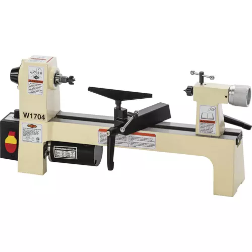

Shop Fox W1704 8" x 13" Benchtop Wood Lathe
Ideal for pen turning and small projects.
The Shop Fox W1704 Wood Lathe is the benchtop model that pen turners and miniature hobbyists demand.
The variable-speed spindle easily adjusts between 750-3200 RPM with the twist of a dial.
The W1704 features cast-iron construction for stability, a 5-3/4" faceplate, 8" of swing over the bed, and 13" of distance between centers.
This lathe includes interchangeable 4-1/4" and 7" tool rests. Either tool rest will lock into a sturdy, quick-adjust base to maximize support where cutting occurs and minimizes leverage when in use.
Extra-large knurled spindle and tailstock knobs help provide an ergonomic grip for manually rotating your workpiece and changing out centers.
Like all Shop Fox lathes, the W1704 comes with a 2-year warranty covering parts and assuring the unit is free from factory defects.
The W1704 manual was written by our U.S.-based Documentation Department is packed with useful information.
The Shop Fox Technical Support team is U.S.-based. Parts for the lathe may be available online and shipped from the Shop Fox parts warehouse in Springfield, MO.
ETL certified
  • Motor: 1/3 HP, 120V, single-phase, 4A
  • Swing over bed: 8"
  • Swing over tool rest base (banjo): 5"
  • Distance between centers: 13"
  • Spindle speed: Variable, 750-3200 RPM
  • Spindle threads: 3/4" x 16 TPI RH
  • Spindle taper: MT#1
  • Tailstock taper: MT#1
  • Footprint: 5-1/2" x 23-1/2"
  • Overall dimensions: 29" W x 10-1/2" D x 13" H
  • Approximate shipping weight: 52 lbs.
  • Two-year warranty!!
  • Variable-speed spindle
  • Precision-ground cast-iron bed
  • Safety paddle switch with removable key
  • Knurled headstock and tailstock knobs for added grip
INCLUDES:
  • MT#1 spur center
  • MT#1 live center
  • 4-1/4" and 7" tool rests
  • 5-3/4" faceplate
  • 3/4" x 16 TPI RH spindle
