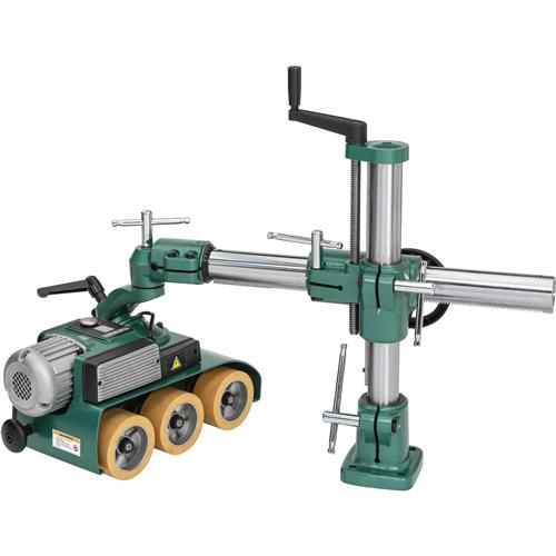

G0826 2/3 HP Variable-Speed 3-Roller Power Feeder, Single-Phase
Perfect brushless power feeder for your shaper.
This all-purpose, heavy-duty G0826 Variable-Speed Power Feeder boasts a 2/3 HP BLDC motor that provides energy-efficient, high-torque, from a single-phase power supply.
No more fussing with gears–just dial in the exact feed speed you need and start cutting thanks to the variable-speed feed control from 7–72 FPM.
This power feeder also automatically compensates for variations in workpiece thicknesses up to 3/4" via a roller-spring mechanism.
Additionally, it comes equipped with a heavy-duty "smart stand, a durable ductile-steel vertical and horizontal support column.
An extra-long support column and arm allows for use on larger woodworking machinery.
It also has a joint that features an "L" locking mechanism for securing the feeder in horizontal, vertical, or angled feeding positions.
Most common machines these are paired with are shapers and router tables, yet can also be used with table saws, jointers, and bandsaws.
Last but not least, the horizontal rotation features a clutch and memory-lock for quick and easy repositioning after blade or cutter changes. This saves significant downtime compared with other power feeders of the same size.
  • Motor: 2/3 HP, 220V, single-phase, 2.3A
  • Feed speed: Variable, 7–72 FPM
  • Swing: 360°
  • Vertical travel: 6-11/16"
  • Horizontal travel: 17"
  • Rotation: Forward and reverse
  • Minimum workpiece length: 6"
  • Rollers: (x3) 2-5/16" x 4-3/4"
  • Roller suspension: 3/4"
  • Maximum height of rollers: 7-1/2"
  • Overall size: 37-1/2" W x 20-1/2" D x 29-1/2" H
  • Approximate shipping weight: 125 lbs.
