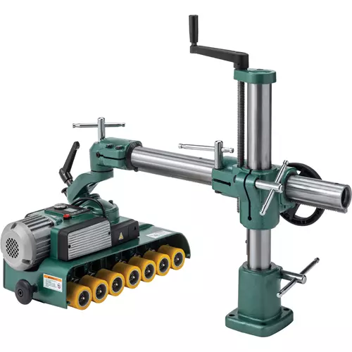

Ramp up your woodworking production with total control and consistency.
Power feeders feed your workpieces for you, giving you factory-like consistency and flawless quality while protecting your hands from spinning blades and cutters.
This power feeder uses digital controls and seven closely spaced rollers for a high level of precision and greater contact with your workpiece as it runs through your table saw or shaper.
The rollers provide consistent hold-down pressure to stabilize your work, preventing sudden movements that can ruin the finished product.
Dial in the speed you need for any project without the hassle of changing gears. Simply set the dial from 7 to 86 FPM and you’re ready to go. And the easy-to-read digital readout tells you exactly what speed you’re at.
Shape and cut figured wood at a slow speed or turn it up for high-speed production work.
The feeder runs on a brushless DC Servo motor that slashes energy costs by 50% while providing torque comparable to 1 HP AC motors.
  • Motor: 2/3 HP, 220V, single-phase, 2.3A
  • Feed speed: Variable, 7–86 FPM
  • Swing: 360°
  • Vertical travel: 7-1/2"
  • Horizontal travel: 16-3/4"
  • Rotation: Forward and reverse
  • Minimum workpiece length: 6"
  • Rollers: (x7) 2-3/8" W x 2-5/16" diameter
  • Roller suspension: 3/8"
  • Maximum height of rollers: 7-1/2"
  • Overall size: 37-1/2" W x 20-1/2" D x 29-1/2" H
  • Approximate shipping weight: 129 lbs.
  • 7 spring-powered rollers
  • Variable-speed adjustment dial
  • Crank handle vertical adjustment
  • Rack-and-pinion horizontal movement
  • Large feed speed digital readout
  • Push-button ON/OFF switch and feed direction
  • 7 rollers allow for safe handling of shorter workpieces
  • Shorter distance between rollers allows for more contact and control of workpiece
