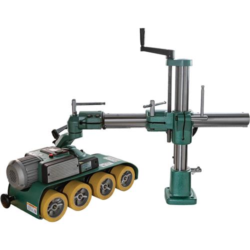

T33926 2/3 HP Variable-Speed 4-Roller Power Feeder, Single-Phase
Increase woodshop production with this efficient variable-speed power feeder.
This 4-roller power feeder is equipped with a 2/3 HP servo motor so you can feed boards with minimal stoppage time.
The servo motor won’t bog down, so you can run stock quickly and efficiently.
This variable-speed power feeder features speeds of 5-72 FPM for versatility depending on your feed speed requirements.
Easily view your speed choice in either imperial or metric with the LED feed rate display; adjust the speed with the convenient dial.
You can send boards through at the push of a button in both forward and reverse as your projects demand.
A rack-and-pinion system provides smooth, methodical motion for horizontal movement, and a crank handle simplifies vertical adjustment.
The power feeder mounts easily to your shaper or table saw and can be removed just as easily.
  • Motor: 2/3 HP, 220V, single-phase, 2.3A
  • Feed speeds: Variable, 5–72 FPM
  • Vertical travel: 9-3/16"
  • Horizontal travel: 17-5/16"
  • Rotation: Forward/reverse
  • Swing: 360°
  • Minimum workpiece length: 6"
  • Rollers: (4) 2-3/8" x 4-3/4"
  • Roller suspension: 11/16"
  • Maximum height of rollers: 7-1/2"
  • Footprint: 5-1/2" x 6"
  • Overall size: 37-1/2" W x 23-1/2" x 30" H
  • Approximate shipping weight: 134 lbs.
  • Tough and effective servo motor
  • LED feed rate display showing both imperial and metric readings
  • Variable-speed adjustment dial
  • Forward/reverse feed
  • Push-button ON/OFF switch and feed direction
  • Rack-and-pinion horizontal movement
  • Crank handle vertical adjustment
  • Easy mounting and removal
We offer U.S.-based customer service and technical support to get your questions answered and help keep your equipment running in top condition. And to ensure your satisfaction, the T33926 comes with a 1-year warranty.
