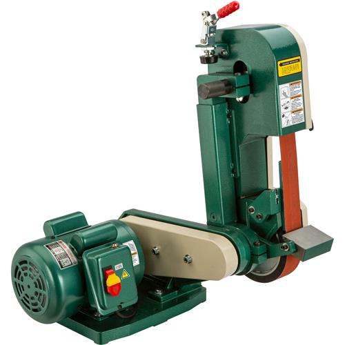

Grizzly G0898 - 2" x 48" 2-Wheel Belt Grinder/Sander
3.5 (2)
$1,295.00
G0898 2" x 48" 2-Wheel Belt Grinder/Sander
Industrial strength with a compact size that works for any shop!
Featuring the popular 2" wide belt, the G0898 2" x 48" 2-Wheel Belt Grinder/Sander is great for knife making and many more uses.
The powerful 1 HP motor moves the belt at 4000 FPM, allowing you to easily remove material from even the toughest steel.
The pivoting action of the head from 0–90° allows you to position the workpiece in the perfect location.
The rigid cast-iron frame reduces chatter during operation.
For use with our wide selection of ceramic and aluminum oxide belts for rapid material removal and shaping.
The G0898 manual was written by our U.S. based Documentation Department is packed with useful information. The complete and easy-to-read manual provides full instructions on how to assemble and maintain your sander.
*This machine is prewired for 110V operation. 220V operation requires purchase and installation of conversion kit P0898061-2X.
  • Motor: 1 HP, 110V/220V (prewired 110V), single-phase, 11A/5.5A
  • Belt size: 2" x 48"
  • Belt speed: 4000 FPM
  • Belt tilt: 0–90°
  • Platen size: 2" x 5-7/8"
  • Work table size: 2-1/2" x 3-5/8"
  • Footprint: 10-1/2" L x 13" W
  • Overall dimensions: 22-1/2" W x 28-1/2" D x 28-1/2" H
  • Approximate shipping weight: 137 lbs.
  • Quick-release belt tension
  • Removable vertical platen
  • Rubber-coated contact wheel
  • Adjustable-angle work table
  • Pivoting cast-iron frame
  • 2" x 48" 150-grit belt included
We offer U.S.-based customer service and technical support to get your questions answered and help keep your equipment running in top condition. And to ensure your satisfaction, the G0898 comes with a 1-year warranty.
