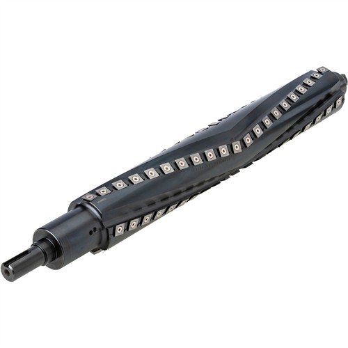

T32021 20" V-helical Cutterhead
Upgrade your Grizzly 20" Planer with a 4-row V-helical cutterhead for a smoother finish.
The T32021 20" V-helical Cutterhead comes equipped with 84 indexable, carbide inserts that can each be rotated three times for a new factory-sharp edge.
The inserts sit at a slight angle, which produces a shearing action, as opposed to the straight-on cuts of spiral cutterheads. This results in a smoother finish and quieter operation.
Additionally, the "V" shape of the rows does a better job of directing dust and chips into your dust collection system than with spiral cutterheads, which tend to eject some debris out the sides.
These cutterheads include 5 extra inserts, a T-handle wrench, Torx® bits and spare insert screws.
These Grizzly cutterheads leave an incredible finish and are comparable to the Byrd® cutterheads in quality of cut as well as the quality of the cutterhead itself.
Replacement inserts for the T32021 20" V-helical Cutterhead can be found on grizzly.com
Like all Grizzly cutterheads, the T32021 comes with a 1-year warranty which covers parts and assures the unit is free from factory defects. (Consumables are not covered by the warranty.)
The Grizzly Customer Service and Technical Support Teams are U.S.-based. Parts for the cutterhead may be available online and shipped from the Grizzly parts warehouse in Springfield, MO.
FITS:
  • Grizzly G1033 Series 20" Planers (mfg. since 1995)
  • Grizzly G0454 series
  • Bridgewood BW20P
  • General 30-300
  • Jet JWP-208-1
  • Jet JWP-208
  • Powermatic 209
  • Shop Fox W1683
  • Shop Fox W1718
  • Shop Fox W1747
  • Shop Fox W1754
  • Shop Fox W1754S
  • Sunhill CT-508
  • Woodtek 924083
