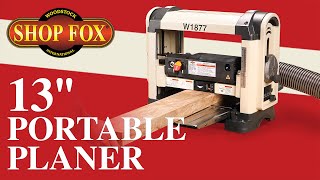

W1877 13" Portable Planer with Spiral-Type Cutterhead
Fixed-base planer finish quality in a portable, benchtop planer platform.
The Shop Fox W1877 13" Portable Planer features a spiral-type cutterhead for smoother finishes, quieter operation, and less maintenance compared with straight-knife cutterheads.
The 26 two-sided, high-speed steel (HSS) inserts sit square to the axis of the cutterhead, with the cutting edges perpendicular to the workpiece. HSS has been heat treated for hardness and wear resistance, which keeps a sharp edge longer than other carbon steels.
This allows you to quickly set the cutterhead to 6 pre-set heights from 1/8" to 1-3/4".
A convenient thickness scale located on the top of the machine helps you keep your eye on your planing progress.
The extension tables fold up for quick transporting and storage.
The cutterhead height lock allows for consistent production work.
The four-sided T32739 replacement inserts are available and sold in packs of ten when the stock inserts get dull. All 26 will need to be replaced at the same time.

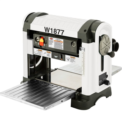

  • Motor: 2 HP, 120V, single-phase, 15A
  • Maximum depth of cut: 1/8" (6" wide board)
  • Maximum stock width: 13"
  • Maximum stock thickness: 6"
  • Minimum stock length: 8"
  • Minimum stock thickness: 1/8"
  • Cutterhead type: Spiral-style with 26 two-sided indexable inserts
  • Carbide insert size: 14.25mm x 14.25mm x 2mm
  • Cutterhead speed: 10,000 RPM
  • Feed rate: 26 FPM
  • Table size with extensions: 13-1/16" x 34"
  • Dust port size: 4"
  • Footprint: 22" x 13-1/2"
  • Overall dimensions: 30" x 34" x 20"
  • Approximate shipping weight: 88 lbs.
  • Spiral-style cutterhead with 26 indexable HSS inserts
  • Stepped depth-of-cut gauge: 1/8"–1-3/4"
  • Stock thickness scale: 0"–6"
  • Built-in dust collection with 4" dust port & 2-1/2" adapter
  • Enclosed tool storage
  • Stainless steel table with folding extensions
