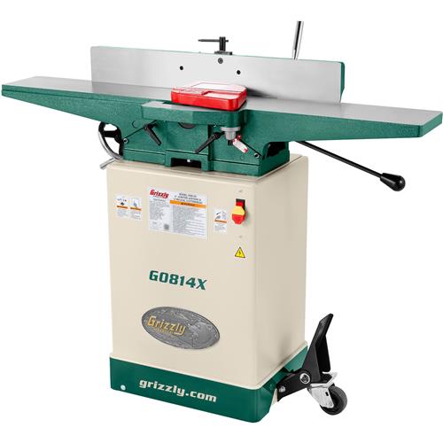

G0814X 6" x 47" Jointer V-Helical Cutterhead
Advanced cutterhead for enhanced woodworking.
Stepping up from our G0814 6" Jointer, the G0814X comes equipped with a 4-row V-helical cutterhead for unmatched finish and long-lasting cutter edge durability.
The innovative V-helical cutterhead uses 24 indexable carbide inserts arranged in a spiral pattern. This design provides a shearing cut that minimizes tear-out, reduces noise, and produces an exceptionally smooth surface. The ability to rotate each insert three times ensures long-lasting cutting performance.
For increased mobility, the cabinet stand comes with a built-in mobile base. Engage the foot pedal caster to move your machine around. Lock the machine down when you are ready to work.
The fence is fully adjustable from 45° to 135°. It has built-in stops at 45°, 90° and 135°.
The precision-ground cast-iron tables move on dovetail ways for smooth and accurate table adjustments.
The H9893 replacement inserts are available when the stock inserts get dull.
