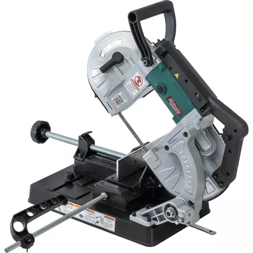

T34441 Portable Metal-Cutting Bandsaw with Stand
Tackle projects in your shop or on the jobsite with this adaptable metal-cutting bandsaw.
Use this multi-purpose, lightweight metal bandsaw like a cutoff saw to cut down metal stock, brackets, and other material for home projects.
Remove the bandsaw from the stand for portable use on the job to slice through pipe, conduit, and even structural tubing.
With efficient variable-speed, this contractor-style metal bandsaw allows for operation at lower speed for hard metals and faster speed for metals like aluminum and brass.
Complete precise angled cuts when running the saw attached to the stand, with a simple on/off switch so you don't have to hold the trigger.
The dual ball-bearing blade guides support the blade on both sides during use to ensure accurate cuts every time.
Whether you need to modify HVAC ductwork or complete home repairs, this portable metal-cutting bandsaw with easy-grip handle is the perfect choice.
FEATURES & BENEFITS:
  • Dual-Function: Use on the stand as a horizontal bandsaw or remove for use as a lightweight portable saw.
  • Variable-Speed: Adjust the cutting speed based on metal type to get the best results.
  • Angled Cutting: Make 0-45° angled cuts when using as a horizontal bandsaw attached to the stand.
  • Heavy-Duty Stand: The sturdy base with convenient adjustable vise,work stop, and on/off switch provides needed support during bandsaw operation.
  • Dual Ball-Bearing Blade Guides: Offer reduced friction, blade stability, and increased blade life.
  • Ergonomic Comfort: A well-designed handle makes repeated cutting a breeze.
  • Carrying Case: Pack up and go to the next jobsite with ease.
  • Motor: 1 HP, 120V, single-phase, 6A
  • Blade size: 44-7/8" x 1/2"
  • Blade speed: 136 - 278 FPM
  • Cutting capacities:
    • 90° Round: 4-5/16"
    • 90° Rectangular: 4-7/16" x 3-5/8"
    • 45° Round: 1-7/8"
    • 45° Rectangular: 1-5/8" x 1-5/8"
    • 30° Round: 2-3/4"
    • 30° Rectangular: 2-3/8" x 2-3/8"
  • Vise jaw height: 2-3/8"
  • Vise depth: 7-1/2"
  • Table size: 13" x 8-1/4"
  • Footprint: 24" x 12"
  • Overall dimensions: 26-1/2" W x 25" D x 14-1/2" H
  • Approximate shipping weight: 42 lbs.
Get this versatile, portable metal bandsaw for consistently clean, straight cuts on all types of metal.
