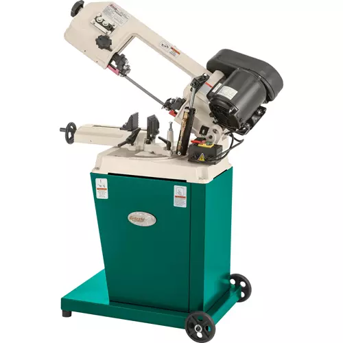

G9742 5" x 6" 1/2 HP Metal-Cutting Bandsaw with Swivel Head
One of the best metal cutting saws on the market for the small or large shop.
The Grizzly G9742 5" x 6" 1/2 HP Metal Cutting Bandsaw features a 5" round and 5" x 6" rectangular stock capacity.
What really sets this apart from other saws of this size is the head swivel giving a maximum angle of cut of 60°!
Remember how much trouble it is to change a vise backing jaw only to get a 45° cut? Not with this machine.
The easy-to-adjust head has stops in all the right places.
And because the vise backing jaw is rigid on this saw, it is taller, giving it the ability to support the workpiece better.
The 1/2 HP motor powers the 97-5/8" blade at three different blade speeds: 80, 120, and 200 feet per minute.
The speed at which the saw blade will cut through a workpiece is controlled by blade type and feed rate.
The feed rate is controlled by the valve lever and feed rate dial on the hydraulic cylinder.
The G9742 comes with all the features you'd expect from Grizzly like hydraulic down feed control, easy access wheels for quick blade changes, and the right blade speeds to do the job.
