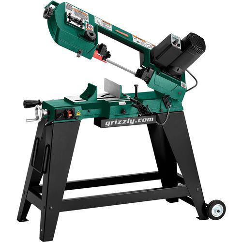

G0926 4" x 5-1/2" Variable-Speed Metal Cutting Bandsaw
Every shop, no matter the size, can put a portable metal-cutting bandsaw to use.
Tackle your metalworking projects with the G0926 4" x 5-1/2" Variable-Speed Metal Cutting Bandsaw.
Cut round and rectangular metal workpieces at blade speeds between 85 and 195 FPM (Feet Per Minute).
Speed adjustments are as simple as rotating the blade speed dial until the speed display shows the speed desired.
The vise consists of a movable jaw and fixed jaw and can hold material up to 6" deep and be set to cut angles from 0° to 45°.
The portable platform with built-in wheels and retractable handle make it ideal for storing away or moving to where ever the job requires.
An adjustable work stop assets allows repetitive cutting operations. It will need to be adjusted any time it is removed or repositioned.
As an added safety feature, an automatic blade shutoff tab turns the machine off when the headstock is fully lowered.
