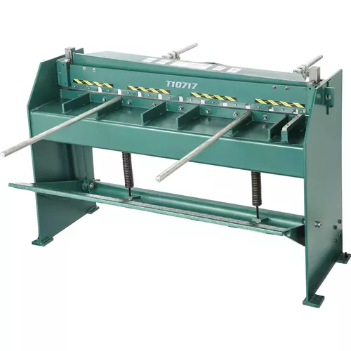

T10717 50" Deluxe Heavy-Duty Shear
Having a hard time distinguishing between all of the best metalworking shears?
This 50" deluxe foot shear has 7/16" thick blades, 0"–35" front scale length, and 0"–24" rear stop scale length with dual locks and micro-adjustable dials. It will cut a maximum of 16-gauge mild steel at half width and 18-gauge mild steel at full width.
The T10717 is designed to use the operator's body weight to cut sheet metal. A stationary blade is mounted to the machine base and a moving blade is connected to the foot pedal. When the foot pedal is pressed down, the upper blade lowers past the lower stationary blade, creating a shearing action, similar to a pair of scissors.
The shear is equipped with front workpiece support rods that provide additional support for large stock and rear micro-adjustable work stops for making repetitive cuts of the same length.
The T10717 manual was written by our U.S.-based Technical Documentation Department. The complete and easy-to-read manual makes it easier to assemble and maintain your shear.
  • Maximum working width: 50"
  • Maximum thickness (mild steel at half width): 16-gauge
  • Maximum thickness (mild steel at full width): 18-gauge
  • Maximum beam lift: 2"
  • Front stop scale range: 0–35"
  • Rear stop scale range: 0–24"
  • Overall dimensions: 62-1/2" W x 72" D x 39-1/2" H
  • Approximate shipping weight: 720 lbs.
  • 1-year limited warranty
