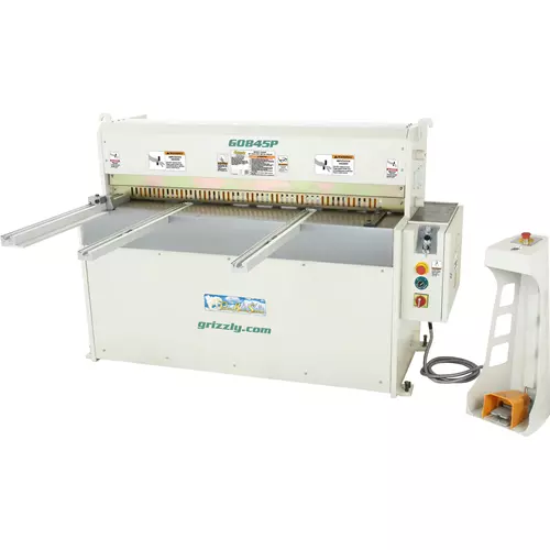

G0845P Heavy-Duty 50" Electric Metal Shear
Built for years of reliable service, this shear is a great choice for production fabrication shops.
The G0845P 50" Electric Metal Shear features a mighty 7-1/2 HP, 220V, 3-phase motor and fully integrated steel frame with hardened steel-alloy dies.
Capable of shearing up to 10-gauge mild steel and 10-gauge aluminum with a 50" maximum cutting width.
It proudly features a hold-down carriage with non-marring nylon fingers, adjustable front/rear work stops for accurate repeatability and a remotely activated foot pedal control that makes it a breeze to cut larger sheets.
Better yet, the relatively small footprint of 28-1/2" x 66-1/2" makes this a perfect option for shops that are tight on space.
  • Motor: 7-1/2 HP, 220V, 3-phase, 20.7A
  • Maximum thickness: 10-gauge steel, 10-gauge aluminum
  • Rear stop adjustment: 0-24"
  • Front stop adjustment: 0-36"
  • Maximum cutting capacity: 50"
  • Maximum beam lift: 1/2" - 1-13/16"
  • Front scale range: 3-5/16" to 39-5/16"
  • Rear scale range: 0 to 25-5/8"
  • Bed height above floor: 31-1/2"
  • Base dimensions: 28-1/2" x 66-1/2"
  • Overall size: 72-1/2"W x 80"D x 48"H
  • Approximate shipping weight: 3266 lbs.
  • Reversible hardened steel alloy cutting sheer dies for extended life
  • Hand and foot pedal operation
  • Micro-switch on finger guard overrides main switch if guard is removed
  • Adjustable front and rear stop scales
  • Triple V-belts drive the counter-balance shaft
  • Remote on/off foot pedal control
  • Super-quiet operation
  • Built-in non-marring hold down clamp
  • Shadow light
Please note that this machine cannot be run on a phase converter; you must use a true 3-phase power supply.
Due to product size, this item must be delivered to a loading dock or unloaded with a forklift. Liftgate service is not available.
Need help? We offer U.S.-based customer service and technical support to get your questions answered and help keep your equipment running in top condition. And to ensure your satisfaction, the G0845P comes with a 1-year warranty.
