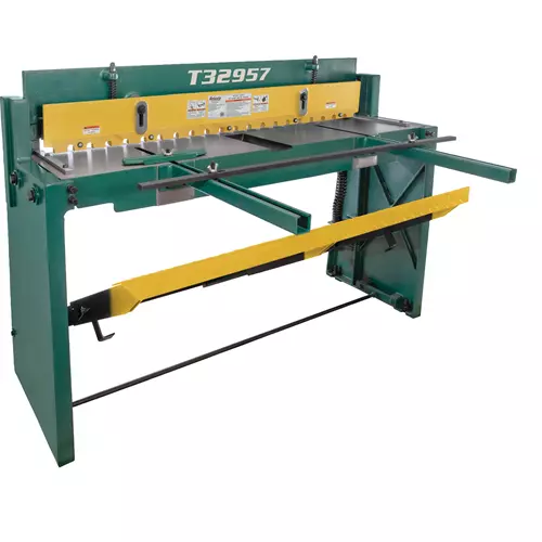

T32957 52" Sheet Metal Shear
Cut your work down to size with this heavy-duty shear.
The T32957 Sheet Metal Shear cuts up to 52" wide with all the precision you'd expect from a machine this size.
Features a heavy cast-iron body with foot control, a precision-ground steel blade, a spring-activated hold down, and a safety guard.
The front stop and angle guide are quickly adjusted by wing nuts on the top of the stops.
The rear extension arms have micro-adjusting stops that allow you to fine tune your cut length.
Also includes table gauges and front extension arms for those really large sheet metal jobs.
SPECIFICATIONS
  • Maximum capacity: 52"
  • Mild steel capacity full width: 18-gauge
  • Mild steel capacity half width: 16-gauge
  • Front stop scale range: 0"–12-1/2"
  • Back stop scale range: 0"–33"
  • Footprint: 60" x 21"
  • Overall shipping dimensions: 62" W x 74" D x 42" H
  • Approximate shipping weight: 1120 lbs.
  • 52" wide capacity
  • Precision-ground steel shear blade
  • Rear extension arms with micro-adjusting stops
  • Blade guard doubles as a hold-down clamp
  • Bevel gauge to support workpieces with angled front edge
  • Steel frame
  • Foot control
