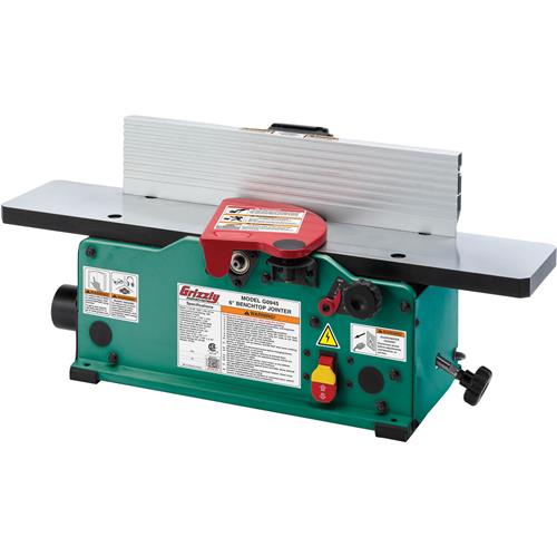

G0945 6" x 30" Benchtop Jointer
The best valued 6" benchtop jointer on the market.
The G0945 6" Benchtop Jointer has a compact size for convenient placement in any shop. It mounts and dismounts quickly to a workbench making it portable when necessary.
It is used to produce straight, flat edges on a workpiece, in order to properly square material for further layout, construction, and jointing.
The 1-7/8" diameter straight-knife cutterhead has two SK5 steel knives to produce a smooth jointing finish.
The fence is constructed from extruded aluminum, making for a truly portable benchtop jointer. Easily stow away when not in use and quickly set-up when ready to use.
The infeed and outfeed tables are constructed from cast aluminum. The depth-of-cut adjustment knob adjusts height of infeed table, controlling depth of cut. The infeed table height adjustment lock secures that height.
