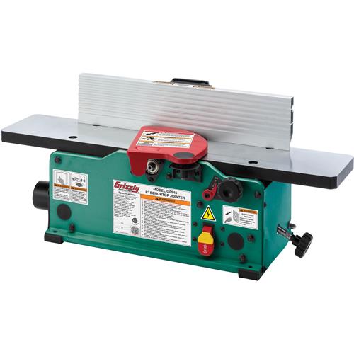

G0945 6" x 30" Benchtop Jointer
The best-valued 6" benchtop jointer on the market.
The G0945 6" Benchtop Jointer has a compact size for convenient placement in any shop. It mounts and dismounts quickly to a workbench making it portable when necessary.
It is used to produce straight, flat edges on a workpiece, in order to properly square material for further layout, construction, and jointing.
The 1-7/8" diameter straight-knife cutterhead has two SK5 steel knives to produce a smooth jointing finish.
The fence is constructed from extruded aluminum, making for a truly portable benchtop jointer. Easily stow away when not in use and quickly set-up when ready to use.
The infeed and outfeed tables are constructed from cast aluminum. The depth-of-cut adjustment knob adjusts height of infeed table, controlling depth of cut. The infeed table height adjustment lock secures that height.
  • Motor: 1-1/2 HP, 120V, single-phase, 10A
  • Maximum width of cut: 6"
  • Maximum depth of cut: 1/8"
  • Minimum workpiece length: 10"
  • Number of cuts per minute: 22,000
  • Cutterhead diameter: 1-7/8"
  • Cutterhead type: 2-Row straight-knife
  • Cutterhead speed: 11,000 RPM
  • Knife type: SK5 steel, single-sided
  • Knife size: 6-1/4" L x 7/8" W x 1/16" T
  • Table size: 6-1/4" x 30"
  • Fence size: 19-3/4" L x 4-5/16" H
  • Dust port size: 2-1/2"
  • Footprint: 9-1/2" x 19-1/2"
  • Overall dimensions: 30" W x 17-1/2" D x 13" H
  • Approx. shipping weight: 44 lbs.
  • Straight-knife cutterhead with two SK5 steel knives
  • Cast aluminum infeed and outfeed tables
  • Infeed table height adjustment lock
  • Built-in dust collection system with 2-1/2" dust port
  • Two push blocks included
