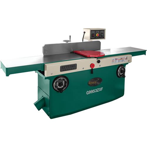

Image for Grizzly G9953ZXF - 16" x 99" 3-Phase Z Series Jointer w/ Spiral Cutterhead

G9953ZXF 16" x 99" 3-Phase Z Series Jointer w/ Spiral Cutterhead
For when you demand smooth operation, large cutting capacity, and mirror-smooth finishes.
Tipping the scales at 1650 pounds, the G9953ZXF features cast-iron throughout including the base, hardened and precision-ground tables, center-mounted fence and table elevation handwheels.
The spiral cutterhead is equipped with 120 indexable carbide inserts that can be rotated to reveal any one of their four cutting edges. Simply rotate each 90° to reveal a fresh cutting edge.
This provides up to 16" wide cut for the finest finish available and a much quieter machine that's unlike any other.
An added safety feature is the cutterhead brake. It turns the machine off and brings the cutterhead to a rapid stop when the handle is rotated.
The G9953ZXF has fence stops that can be set at 90° or 45°. If you require a different angle, the fence can be locked in place anywhere between these angles.
The H7319 replacement inserts are available.
