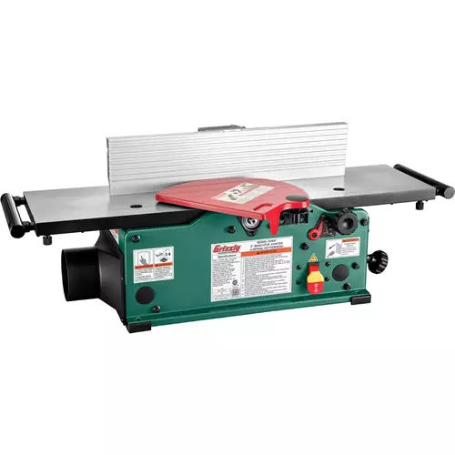

Grizzly G0947 - 8" Benchtop Jointer with Spiral-Type Cutterhead
4.7 (102)
90
$595.00
  • Motor: 1-1/2 HP
  • Table size: 34 in. x 8-1/4 in.
  • Table type: Cast Aluminum
  • Table adjustment: Swing
  • Cutterhead type: Spiral
  • Cutterhead diameter: 2 in.
  • Max depth of cut: 1/8 in.
  • Fence size: 4-1/4 in. x 19-3/4 in.
  • Shipping weight: 59 lbs.
G0947 8" x 34" Benchtop Jointer with Spiral-Type Cutterhead
The best valued 8" benchtop jointer on the market.
This benchtop jointer has an 8" cutterhead providing the same capacity as a typical floor model-style jointer, without taking up all the floorspace. The compact size makes it easy to move between jobsites and easy to store.
The spiral-type cutterhead provides smoother finishes, quieter operation, and less maintenance compared to straight-knife cutterheads.
The cutting edges of the 16 high-speed steel (HSS) inserts sit perpendicular to the workpiece. Each two-sided insert can each be rotated once to expose a new sharp edge. HSS has been heat treated for hardness and wear resistance, which keeps a sharp edge longer than other carbon steels.
Each two-sided insert can each be rotated once to expose a new sharp edge. The overall size of the inserts contacting the lumber reduces noise due to a smaller pattern of air being pushed by the cutterhead.
The T32739 replacement inserts are available and sold in packs of ten when the stock inserts get dull. All 12 will need to be replaced at the same time.
The sawdust created by this machine is then finer which is less likely to create clogged dust lines. Coming standard with a 4" dust port, the G0947 includes a 2-1/2" dust port adapter which is handy for smaller collectors or larger shop vacs in garage-size woodshops.
The 1-1/2 HP motor is bigger than “traditional” 1 HP motor options from other brands.
The bars extend the overall table size from 34" to 52" and can be locked by-hand at any point in between to support the workpiece.
They provide more support for long workpieces than other benchtop models and also double as handles for carrying the machine.
Lightweight and ready for the jobsite or in the garage.
  • Motor: 1-1/2 HP, 120V, single-phase, 10A
  • Maximum width of cut: 8"
  • Maximum depth of cut: 1/8"
  • Minimum workpiece length: 10"
  • Cutterhead: 6-Row spiral-type
  • Cutterhead speed: 12,000 RPM
  • Cutter insert size: 14.25mm x 14.25mm x 2mm
  • Number of inserts: 16
  • Bevel jointing: 0–45°
  • Table size: 8-1/4" x 34"
  • Overall dimensions: 52" W x 20" D x 13" H
  • Approx. shipping weight: 59 lbs.
  • 8" infeed/outfeed table extensions
  • Cast aluminum infeed and outfeed tables
  • Infeed table height adjustment lock
  • 1-year limited warranty
Need help? We offer U.S.-based customer service and technical support to get your questions answered and help keep your equipment running in top condition. And to ensure your satisfaction, the G0947 comes with a 1-year warranty.
