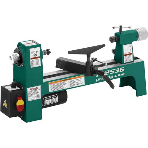

T32536 8" x 13" Variable-Speed Benchtop Wood Lathe
A great entry-level wood lathe for turning bowls and spindles up to 13" long.
The Grizzly T32536 8" x 13" Benchtop Wood Lathe offers the precision and control that pen turners and miniature hobbyists demand.
The T32536 features cast-iron construction, a 5-3/4" faceplate, 8" of swing over the bed, and 13" of distance between centers.
This lathe comes with two interchangeable 4-1/4" and 7" tool rests. When in use, either tool rest will lock into a sturdy, quick-adjust base to maximize support where cutting occurs and minimizes leverage.
The tailstock has an MT#1 taper, fine adjustment knob, and is equipped with a cam-action clamping system allowing it to be positioned anywhere along the bed with ease.
Easily adjust the variable-speed range between 750-3200 RPM with the twist of the spindle speed dial.
Extra-large knurled spindle and tailstock knobs help provide an ergonomic grip for manually rotating your workpiece and changing out centers.

  • Motor: 1/3 HP, 120V, single-phase, 4A
  • Swing over bed: 8"
  • Swing over tool rest base: 5"
  • Distance between centers: 13"
  • Floor to center height: 9-3/4"
  • Spindle speed: Variable, 750–3200 RPM
  • Spindle threads: 3/4" x 16 TPI RH
  • Spindle taper: MT#1
  • Tailstock taper: MT#1
  • Footprint: 23-1/2" x 5-1/2"
  • Overall dimensions: 29" W x 10-1/2" D x 13" H
  • Approximate shipping weight: 52 lbs.
  • Safety paddle switch with removable key
  • Knurled headstock and tailstock knobs for added grip
  • Variable-speed spindle
  • Precision-ground cast-iron bed
  • Right hand spindle 3/4" x 16 TPI
INCLUDES:
  • MT#1 spur center
  • MT#1 live center
  • 4-1/4" and 7" tool rests
  • 5-3/4" faceplate
