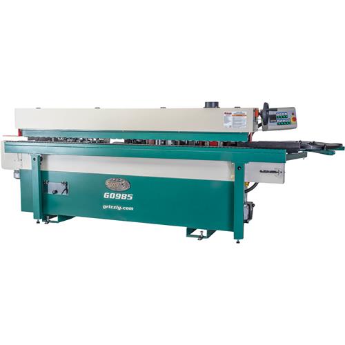

G0985 Automatic Edgebander w/ Pre-Milling Function
Commercial-grade features for high-volume professional automatic edgebanding.
This powerhouse provides flawless results for intensive edgebanding production and exceptional outcomes on every project.
This advanced edgebander automatically preps your workpiece edge with a pre-milling function and a heated infeed fence for enhanced glue adhesion.
It features a radius scraping unit that removes glue squeeze-out, for improved finish and prep for the final trim.
Also included is a multi-functional end trimmer that lets you choose between flush and beveled trims, so you get the most refined finished product.
Additional advanced features include copy tracing wheels with dual buffing, an extension bar for supporting larger workpieces, and a user-friendly Programmable Logic Control (PLC) system with LED display.
No matter the shop or production setting, this automatic edgebander will streamline your workflow.
  • Pre-Milling with Dual Diamond Cutterheads: Counter-rotating cutterheads create a perfectly smooth surface for optimal adhesion of edgebanding material.
  • Heated Infeed Fence: Preheats panels for optimal glue penetration and a durable bond.
  • Radius Scraping Unit: Refines the edge radius and removes excess glue for a flawless finish.
  • High-Speed Dual-Blade End Trimming Unit: Cuts excess banding flush with panel ends.
  • Multifunctional Trimming Unit: Switch between flush and beveled trims for thin edges or radius trims for thicker edges.
  • Top and Bottom Trimmers w/ Copy Tracing Wheels: Follow workpiece contours for precise trimming and a polished appearance.
  • Dual Buffing Units: Includes upper and lower units to polish ABS and PVC edging to a high gloss and remove discoloration.
  • Heavy-Duty Pressure Beam w/ Extendable Support: Provides stability and support for large panels.
  • PLC Control System w/ LED Display: Quickly adjust settings and monitor machine performance for efficient operation.
  • Dual Spring-Loaded Pressure Rollers: Apply consistent pressure for a secure bond between the edgebanding and panel.
  • Teflon-Coated Glue Pot: Uses five heating elements to prevent glue buildup and simplifies cleaning.
  • Power requirement: 220V, 3-phase, 60Hz
  • Feed motor: 1 HP, 3-phase, 3.1A
  • Pre-mill motor: 2 HP, 3-phase, 5.8A
  • Glue spindle motor: 1/3 HP, 3-phase, 1.6A
  • End trim motor: 1/4 HP, 3-phase, 0.8A
  • Flush trim motor: 3/4 HP, 3-pahse, 2A
  • Buffing motor: 1/6 HP, 3-phase, 0.6A
  • Heating element: 1440W
  • Table size: 120-5/8" L x 3-1/8" W x 33" H
  • Min. panel width: 3-9/16"
  • Min. panel length: 6-3/4"
  • Panel thickness: 1/2" - 1-3/4"
  • Tape thickness: 0.5 - 3.0mm
  • Air requirement: 6 SCFM @ 100 PSI
  • Glue pot capacity: 34 oz.
  • Edgebanding coil capacity: 29-1/2"
  • Dust collection requirement (at dust port): 1100 CFM
  • Overall dimensions: 136" W x 47-1/2" D x 51-1/2" H
  • Approximate shipping weight: 1,841 lbs.
